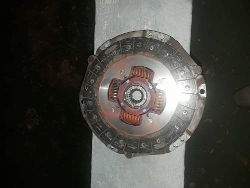

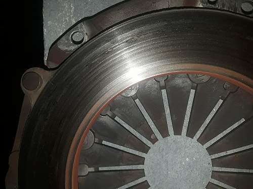

    Rust...? it... rusted? da fuck... car doesn't sit for more than a few days at a time. I mean I get stuff like rotors can surface rust in a day but a clutch?
    Last pic it's hard to see but there are small hot spots all around the pressure plate.
