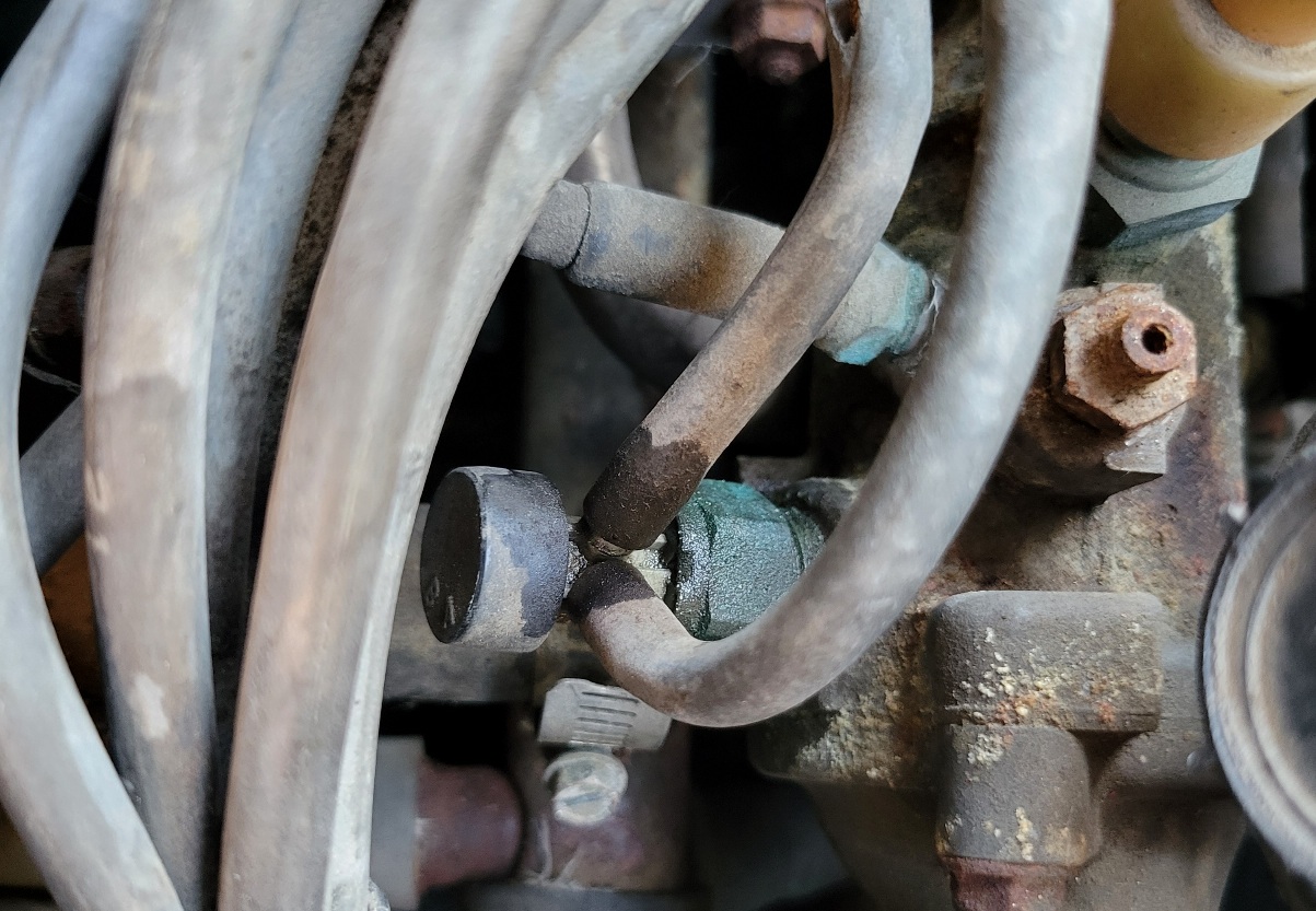

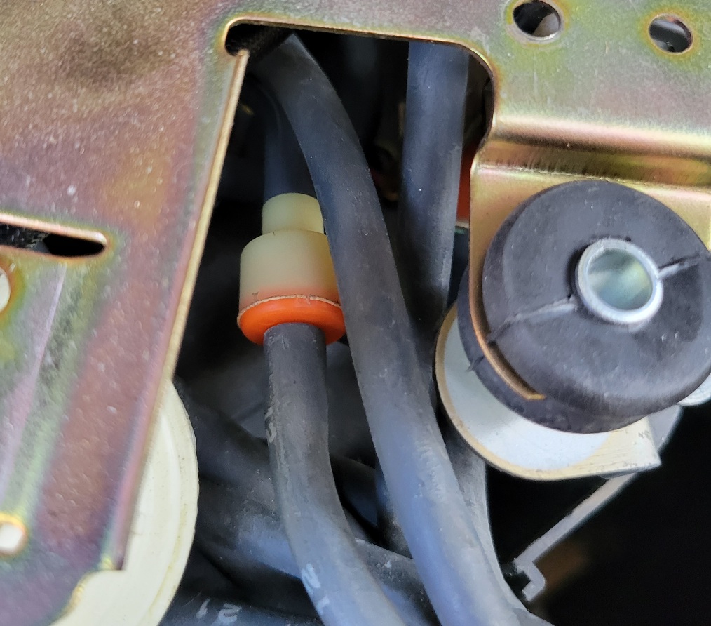

    So, I had the code 12 and did a vacuum test on the EGR valve and it holds a vacuum and will stall out the car. So then from what I read it led me to the filters and cvc in the dreaded black box. I cleaned and gently blew out everything. The cvc valve took a little bit to have the cleaner go through it. And when gently blowing it out some black crud came out. I figured since I was cleaning things out I pulled the #3 hose off the black canister and was labeled pvc. When I added cleaner to that vacuum line and blew it out cleaner came out near the thermostat on a valve that has two vacuum lines on it. Is that telling me there's a vacuum leak there or is it supposed to vent there? It should be the last picture. Oh and it's an 87 LX-i. After I got done I started it and ran it for 20 minutes and no PGM-FI light so I took it for a drive. And maybe a half a mile into it the car stalled but never threw a PGM-FI light on. This happened 1 more time on the way back home. Any help would be appreciated.

    only thing I can add is that last picture my thermostat housing does not have that thermo sensor with the two vacuum lines on it. Mine is a 87 lxi J code car.
    That's what I saw on my spare motor it doesn't have the thermo sensor. But my spare motor is from an 89 lxi.

    Ok the back ground info I forgot to mention was the 1986 lxi have some unusual thermosensors like that for some reason. So you may consult the 86 book for some of that if there is one available.
    It's funny you say that, because the build date is December of 1986. I did just order a 1987 Factory Service Manual and Electrical Manual on ebay for $43 shipped. Hard to beat that and I just like having the big books vs a pdf. So after checking the 86 Manual it looks like a Thermowax Switching Valve? The picture of the 87 Manual doesn't show it. But definitely there was some cleaner coming out of that valve when I was spraying MAF Sensor Cleaner in the vacuum line.
    Yes thermowax valve. It goes open at a certain temperature. There is a little was pellet I guess inside that moves with the temp. There are some post in the EFI section there was a guy that had an 86 with fuel injection he was troubleshooting something.
    PS. bleed the air out of your coolant of course it doesnt hurt.
