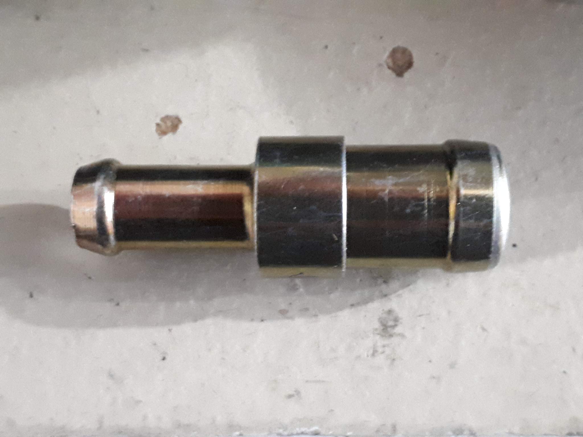

    This is a photo of the replacement PCV valve. It measures 1 and 3/4 of an inch. I can't find anything like it under the hood. Hopefully they sold me the correct one.

    The hose goes to the valve cover try following it back to the intake manifold. The PVC is in the intake manifold someplace.

    It's basically dead center of the intake manifold. 1 big hose coming off it, I believe it's a U shaped hose.
    I would actually be careful replacing it, those hoses will crack and you can't replace it with normal hose due to the silly shape. I'd return the valve even, not a lot to go wrong in a metal valve with a ball and a spring in it... If it was ever stuck carb cleaner and a small amount of blunt force will fix it
    That sounds like good advice. I think I will leave it alone until it starts to cause some problems.
    Getting parts for this car is becoming challenging and I don't want to break anything during the disassembly process.
    I also found this post which basically says the same thing i.e. parts are brittle
    https://www.3geez.com/forum/showthre...valve-location
    "it is right in front of the carb, there is a hole made in the manifold there and you will see a U shaped short fat hose. the pvc is directly under that hose. There is a hard plastic tube that snaps in that hold made in the manifold from underneath. Careful because all that is brittle."
