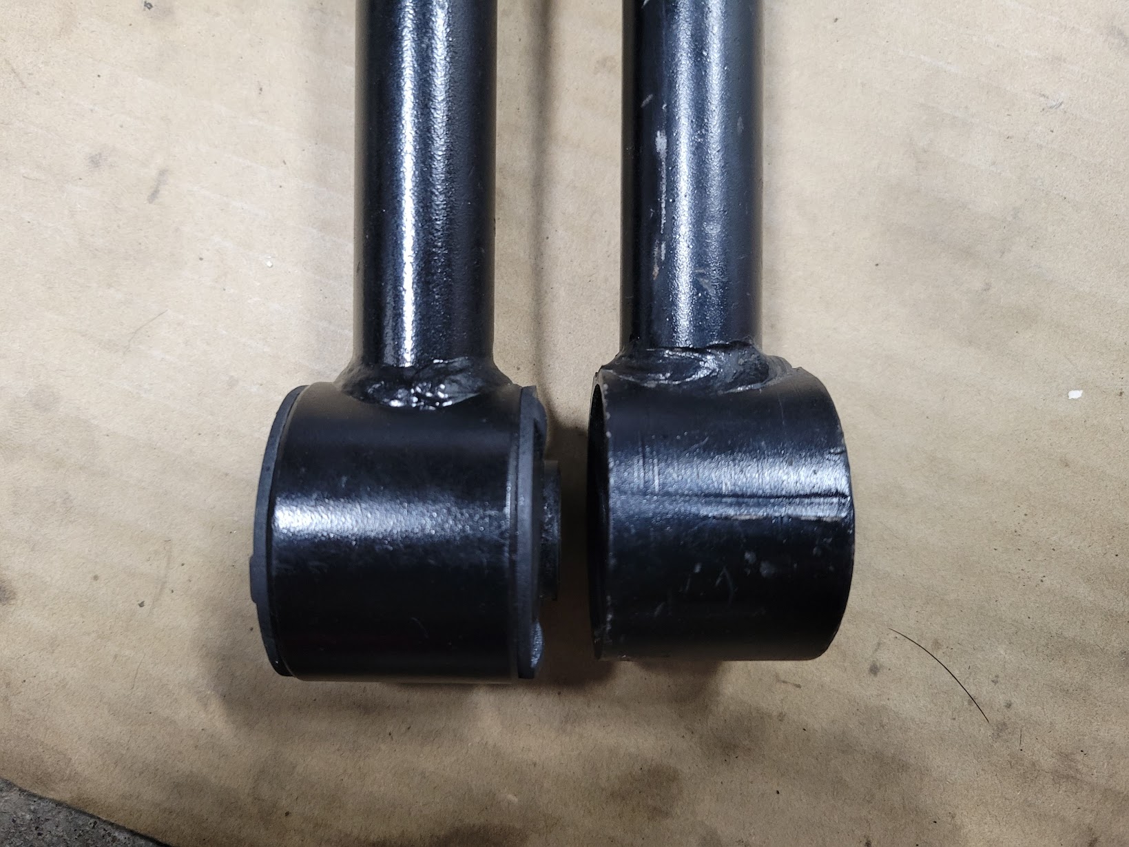

    Alright, I don't know what it is with these cars and their weird engine mount variations but they keep throwing me for loops. I'm just trying to fix these darn idle vibrations gosh dang it...

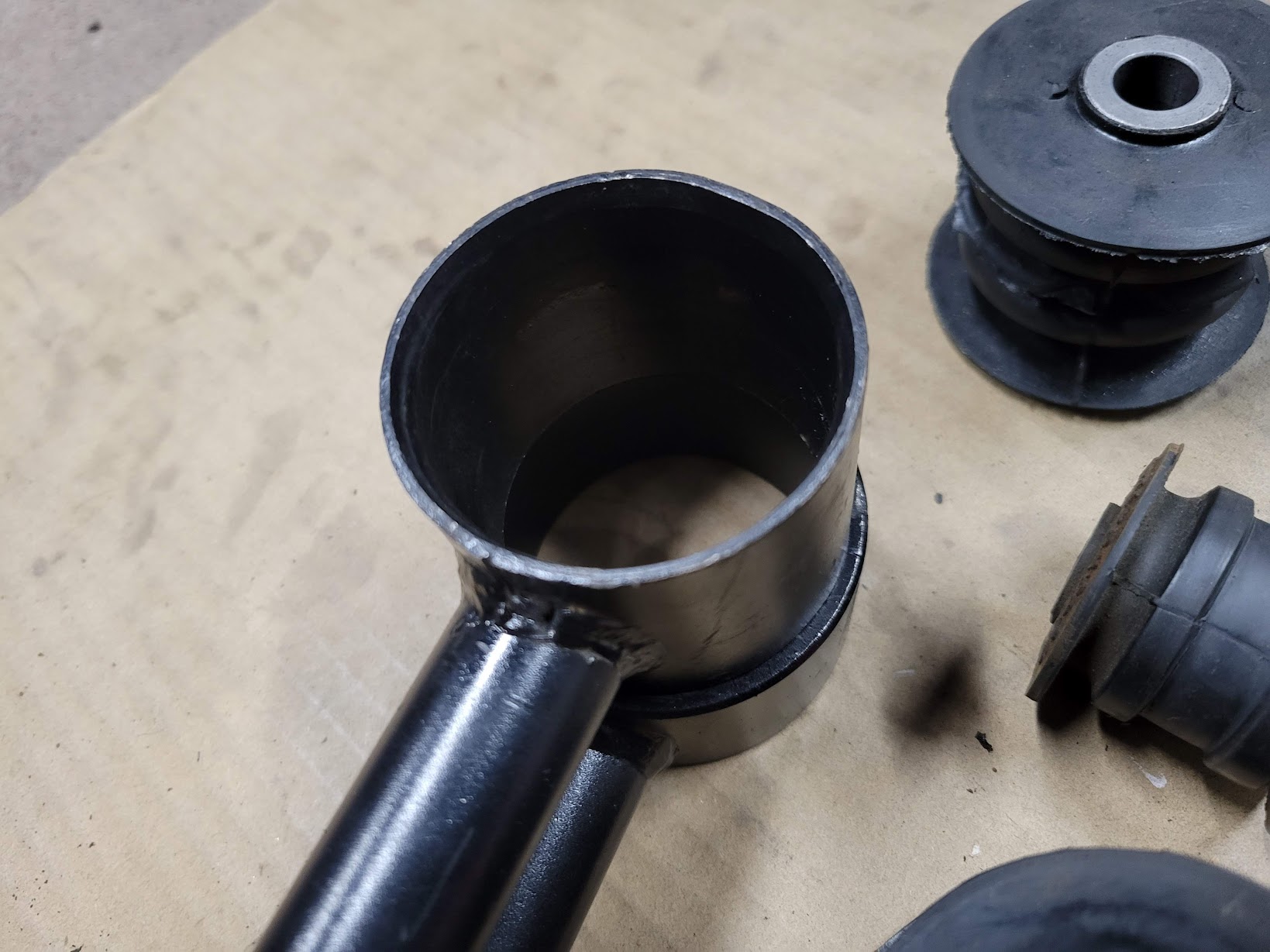

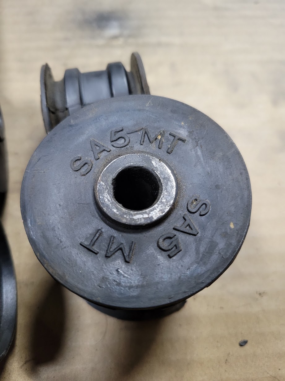

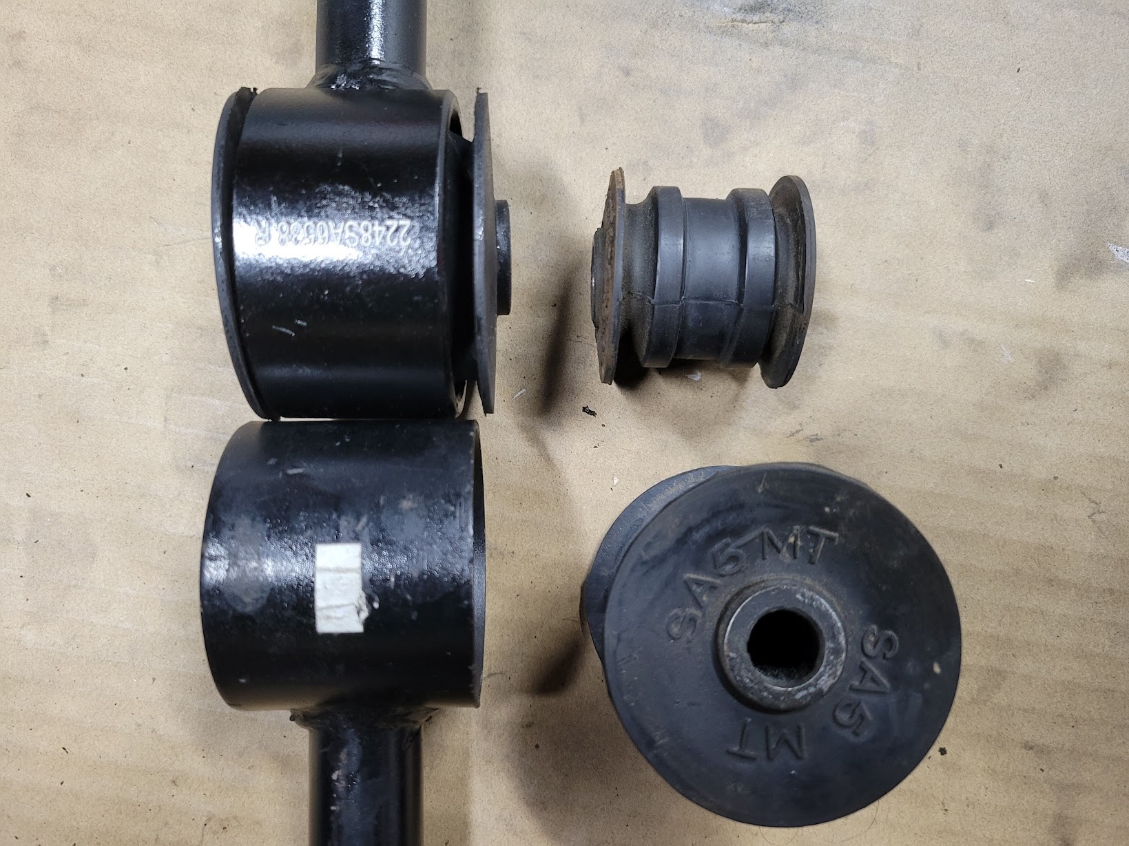

    I was just about to swap in a new torque mount (the dog bone tie on top of the engine) and noticed that my new one is different from the one I just pulled out. Not only is the width of the larger hoop slightly different, but so is the diameter, and even the length of the arm. It doesn't look like the one I pulled out is original either, which is unfortunate since I don't have a ground zero to compare to. Additionally, the larger bushing from the one that was in the car says 5MT on it, and this is an auto car, so what gives? Are there differences or something?

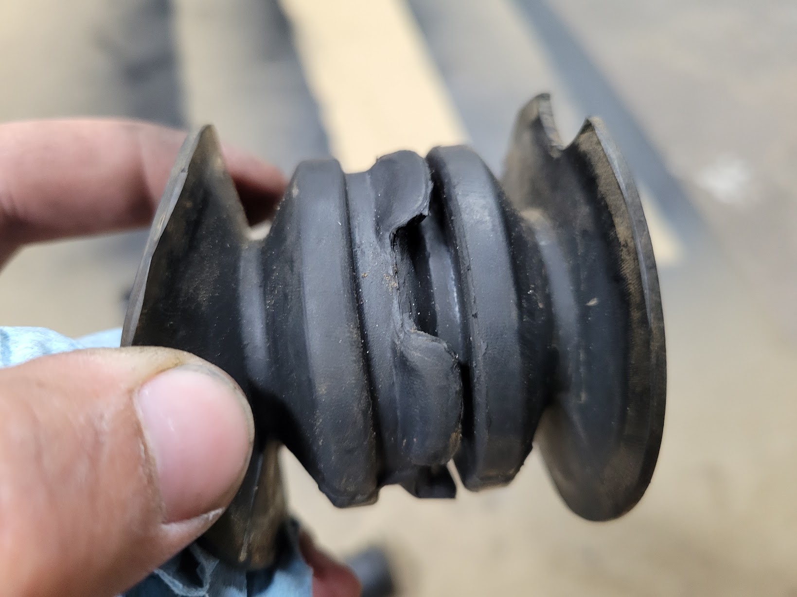

    The new smaller bushing seems to be identical, so no concerns there. The new larger bushing seems to be identical to the one I pulled out as well (minus the 5MT lettering), however it came pre-installed in a much different shaped hoop than the original. The original also appears significantly squished like it wasn't suppose to fit in the smaller hoop. The larger bushing also doesn't fill the full width of the new arm, which almost makes it seem like the old arm is correct, except for how terrible squished the old bushing is.
    So anyway, if you're still somehow with me and aren't already confused enough, here's a handful of photos.

    Any thoughts here would be greatly appreciated. I genuinely do not understand why the mounts for these things seem so off in the aftermarket.

    Anywhosit, I replaced the dogbone with the new one and the idle vibrations when in gear at a stop (to clarify) have improved a good bit. The rattle I was noticing is also gone. Because of the incorrect taller front engine mount leaning the engine slightly backwards and to the right, it is unfortunately slid all the way to the one end of the slotted bolt hole, but I don't think there's much to do about that (other than find the right front engine mount).
    Still curious about the differences between the various dogbones and why I have two that simply don't match. Open to ideas.
