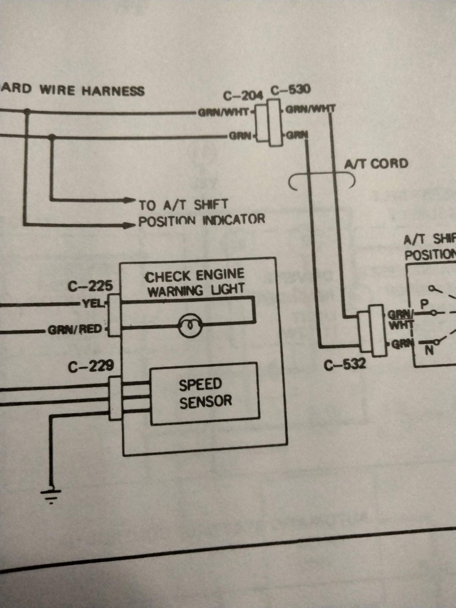

    Well, it appears the yellow wire comes straight from the interior fuse box to the CEL with a single connecter between them.

    If I traced my wires correctly if I remove this fuse, the CEL goes out, but the ECU will still flash codes

    Yes, thats what Im trying to achieve. Disable the light only. Car runs fine.... I guess I could just put a black piece of tape over it lol
    Wiring diagram shows that the yellow wire only powers the CEL, & NOTHING else.
