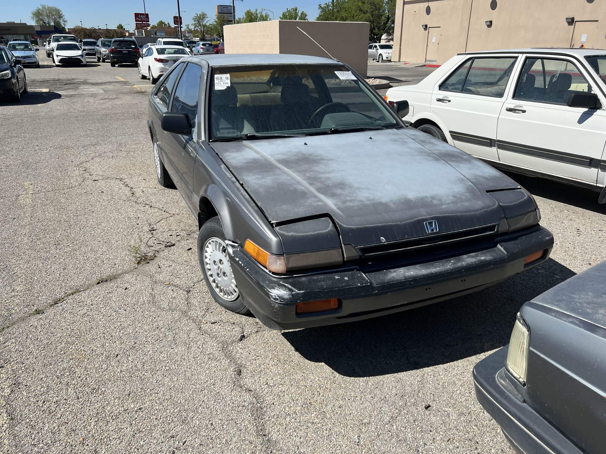

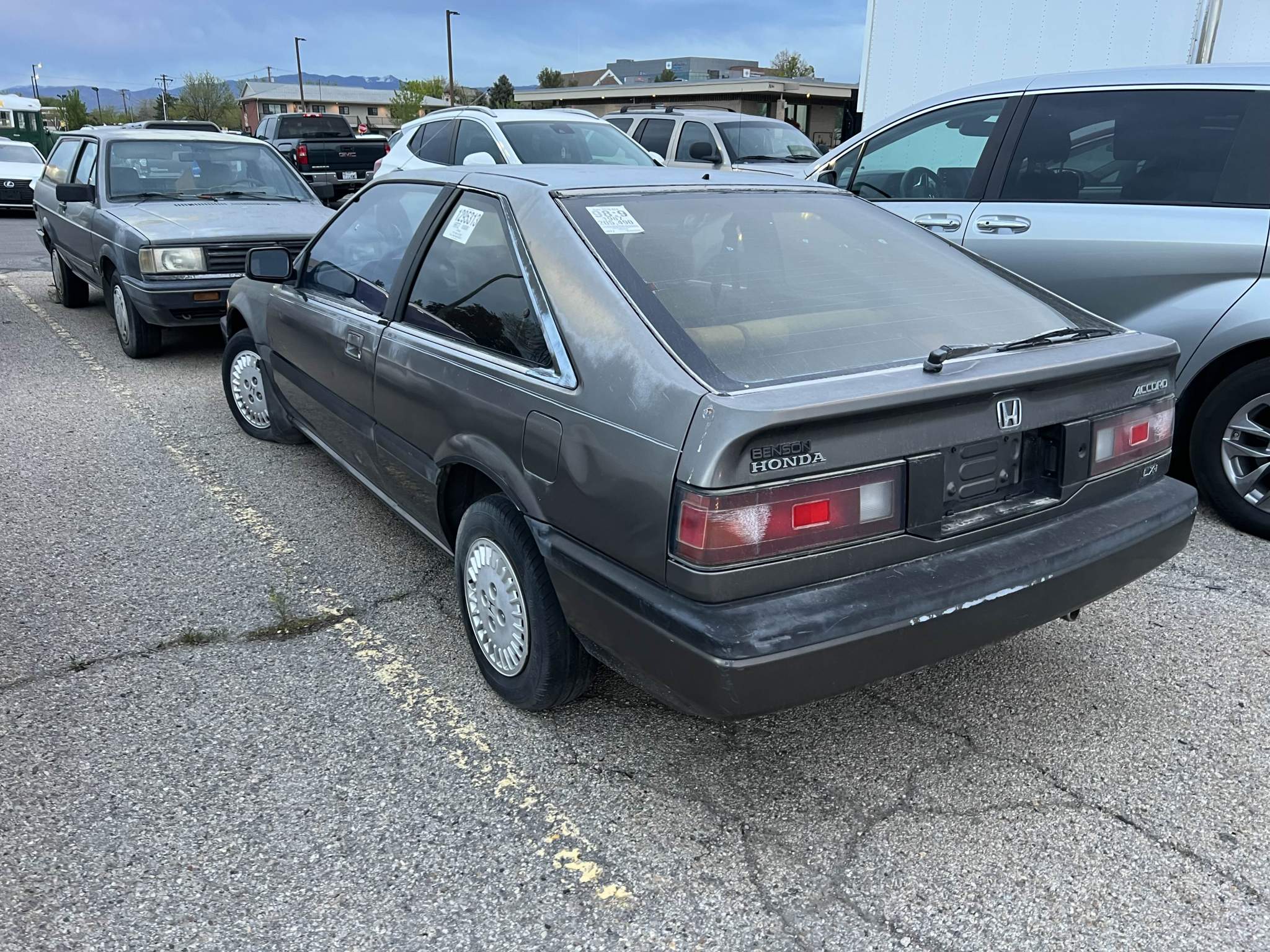

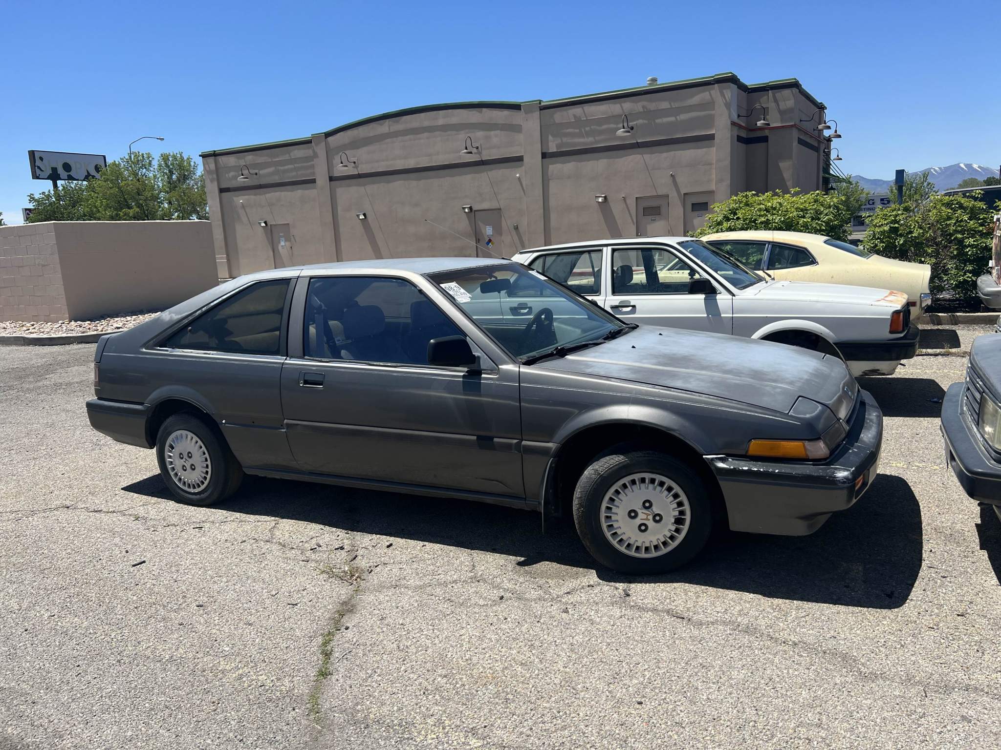

    I wanted a place to journal about this project in its entirety and i was directed to this forum here so, here we go.
    History: I bought a 1987 Accord Hatch in Utah for $400 back in 2023, owner bought it from auction and it basically just sat since 2016 in his yard, according to him he never even touched it beforehand.
    Pics should be attached, i dont know how this works.
    It had 298K miles on the dash. a few dents here and there, but overall really nice. i threw a battery in, fresh oil/coolant and plugs, and she ran like a dream for the next 2 years, then finally...
    Disaster struck
    Cylinder 3 let itsself go during a road trip a few hours away from home, happened outta nowhere, was stranded but thankfully i had Triple A, they got me and the Accord Home safe n sound, but i was pretty heartbroken. she was my daily. i didnt wanna see her sit and rot. I had to do something.
    Current day: the car sits next to one of my other old cars, a 77 trans AM (thats a project for me and my future kid to dig into when that time comes so its not being messed with) but some hoodlums thought it would be funny to dump paint stripper/aircraft paint remover and scrape up the body, so she's a bit mess. never found out who did it but it only hit me harder seeing it look so discolored and beat up.

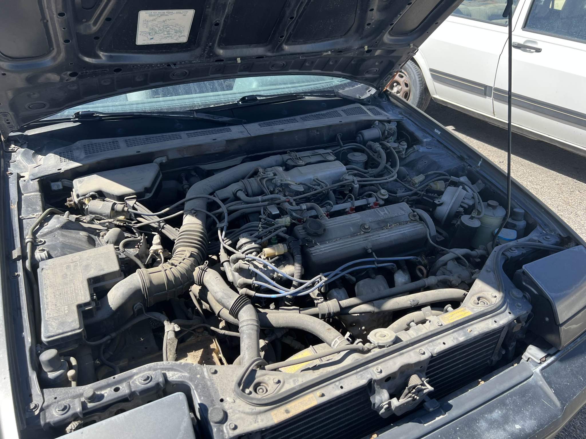

    Under the Hood: I decided ill try to clean it up the best i could, i dont know anything about body work but ive messed with mechanics for 7+ years now. i got to work on pulling out the motor and transmission, and at this moment the engine bay is nearly completely empty, the brake booster is still there but it was going out anyway from what i could recall. once i remove that, the engine bay will be completely empty.

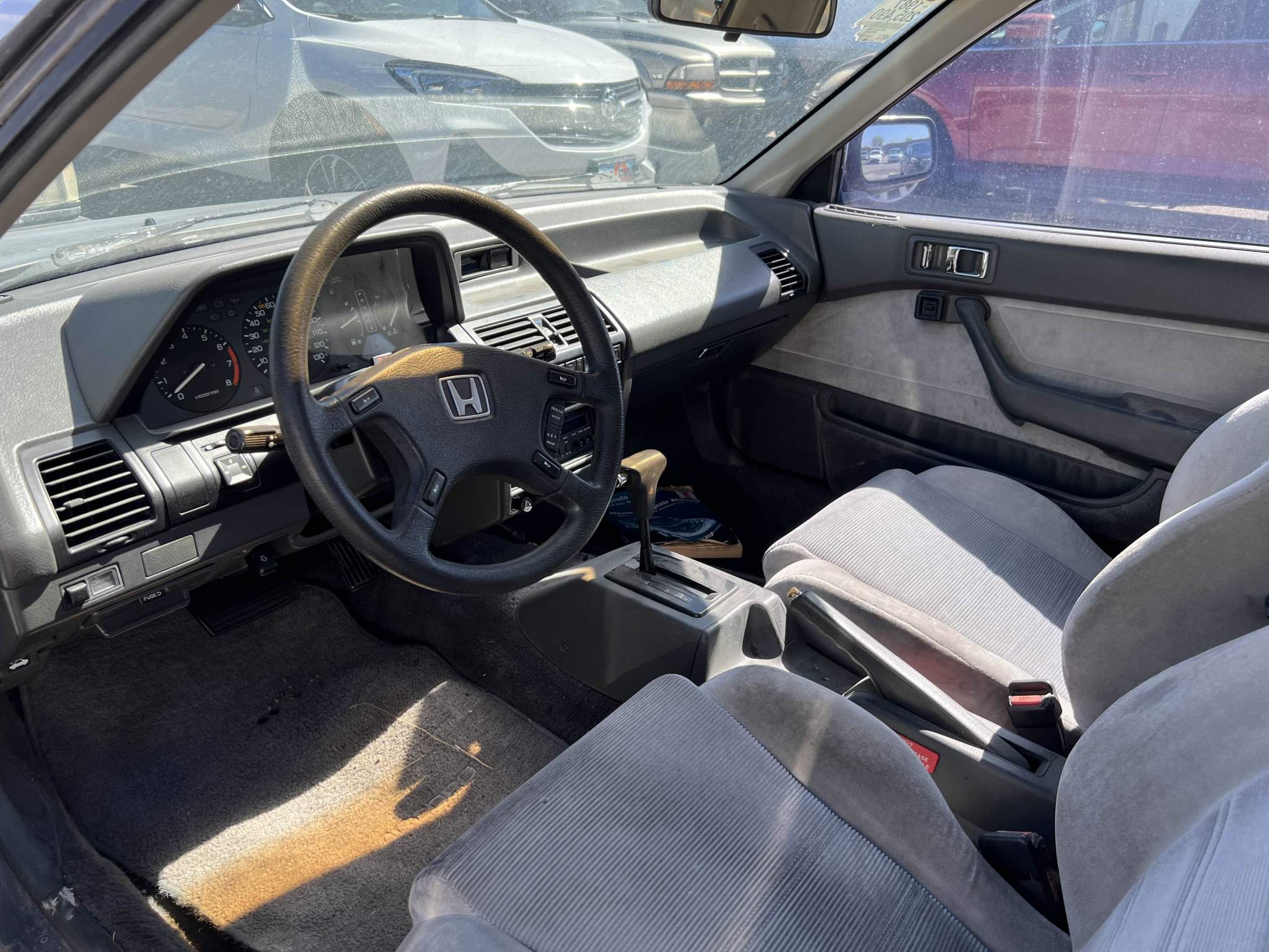

    The Interior: So, along with clearing the entire engine bay, i went ahead and wanted to redo the entirety of the interior, the headliner was drooping down and torn in some spots, the Carpets had rips and tears, unfortunately so did the driver seat and for whatever reason i could NOT get the damn stains out of anything no matter what i used. so i removed all the carpet, seats, and plastic bits, all thats left is a portion of the dash and the wiring thats connected to it and then the car is basically completely stripped.
    My Current plan:While i await on the seats and custom carpet/headliner and the new dash i bought from another 3rd gen owner, i wanted to pick out a new heart for the beast, i read around the forum for a handful of hours looking through everyones swap choices and ideas that were thrown into the pit.
    Where i live, B series motors are hard to come by and people want way too much for them with Uber high miles and or nearing their lifespans end. D series? while yes its a more widely available option, i wanted something more recent and easy to snag parts for. F and H series for me are outta the question, cant find them anywhere in a 100 Mile radius, and i dont really trust Ebay. J series? i read up on someone who managed to fit one in a crx but thats about it. and i preferred to keep my i4 layout. so i settled on the k series, i dont see alot of actual builds of the 3rd gens with K swaps, just alot of threads about wanting to do it or doing it then they disappear after one thread.
    I looked around my area and found 2 donor cars, an 07 Acura TSX and an 06 Accord Coupe, both with a K series under the hood:
    The TSX having the K24A2 and the accord having the K20A8 from what i could tell.
    Anyway, i bought both of them for $600 together, they both had body damage and such, owner claimed they didnt run and drive, but he also mentioned they were both his cars. i got them home and threw a battery and gas in them, and both roared to life with not even a check engine light. trans shifted into all gears. (they're automatic)
    Ill be grabbing a truck tomorrow to go and pick up both cars and bring them back home to the garage to start ripping the hearts out, ill have pictures included when i grab them if anyones interested.
