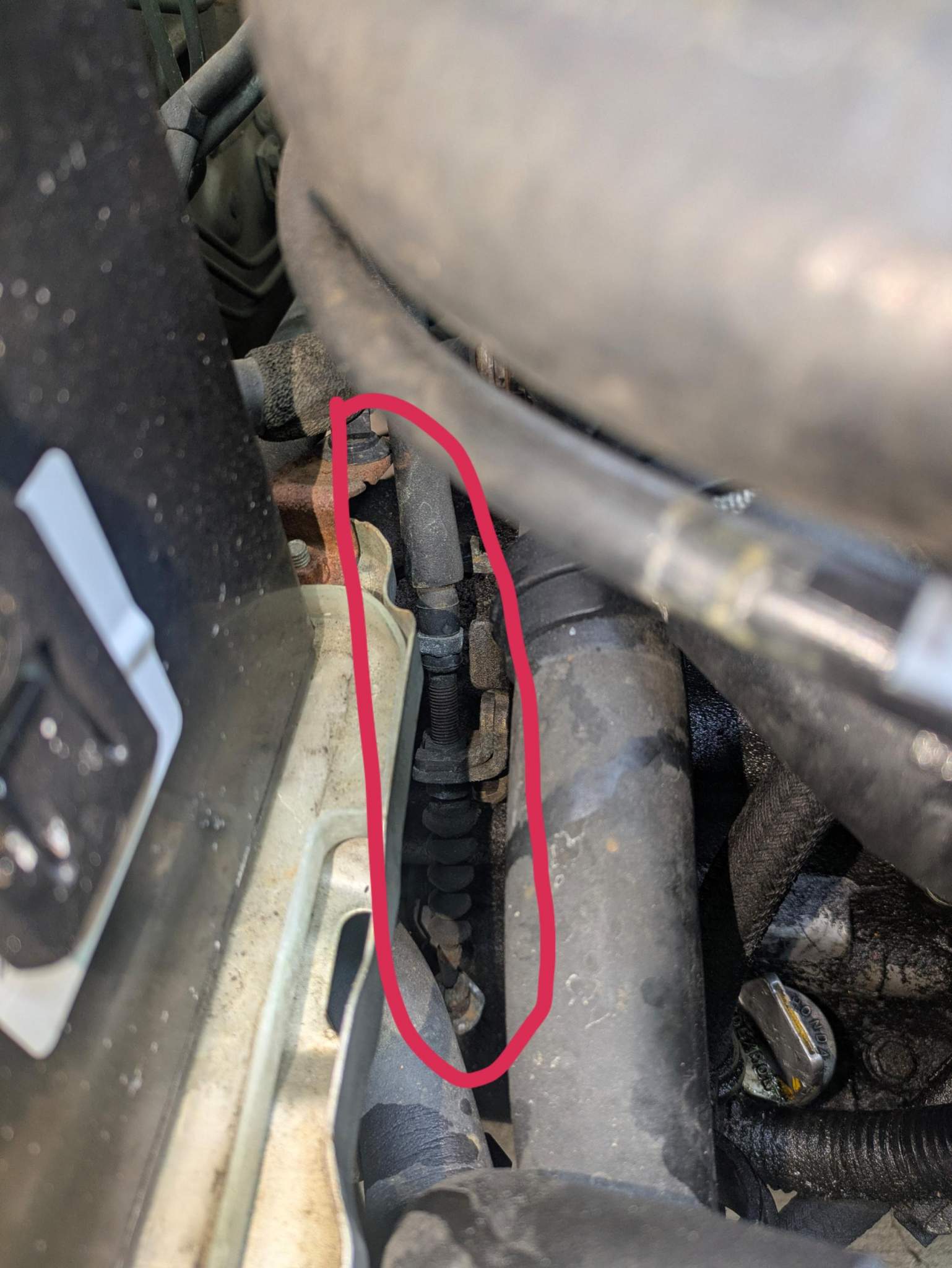

    Alright this is starting to make sense. I drew a line around what I think the kickdown cable is. Circled in the second pic going into the transmission. This cable came from the same spot as the throttle cable in the firewall. I relinked the throttle cable to the weber when swapping. Didn't touch the kickdown cable. I ignored it at the time bc I didn't know what it was and didn't see it mentioned anywhere.
    I barely drove my car at all before swapping for a weber so I can't remember how hard the transmission was shifting before, but it shifts a little rough right now. Doesn't slip at least. I changed the transmission fluid 3 times over the last 4 months, which helped a little bit each time. My throttle cable has some slack to it, so I have to push the peddle down maybe half an inch before it activates. Could this slack be causing an issue with misalignment with the kickdown cable and therefore making the shifting rough?

    Yeah that's what I was saying about the kickdown being connected to the pedal, which seems to be the common trend, but not all cars are that way
