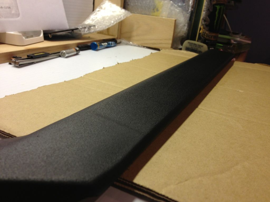

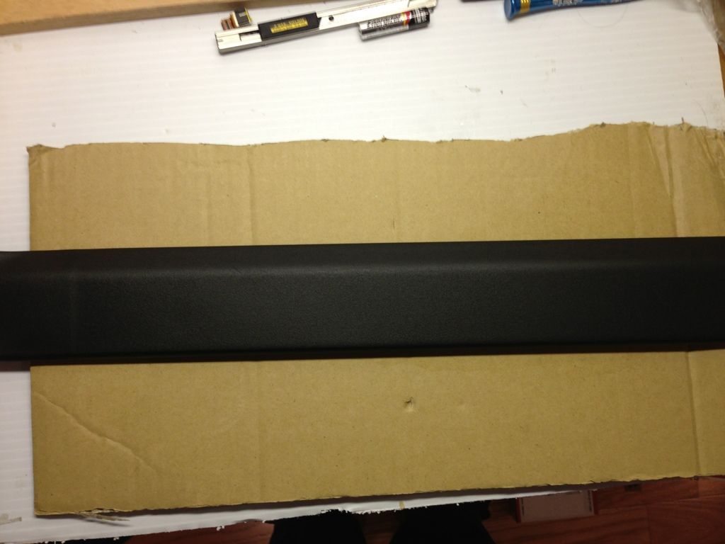

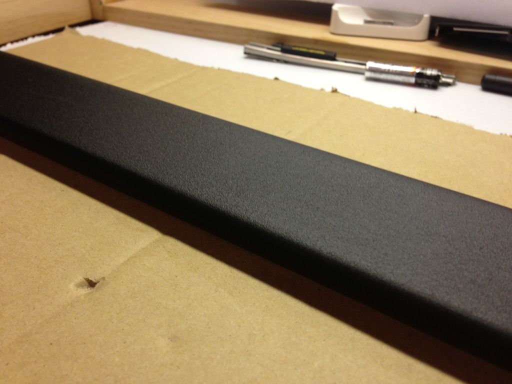

    The people that had the car before me decided to paint the trim with a brush, and some bucket paint. This has been driving me crazy since I got the car. Decided I would try restoring the trim to the factory look.
    I started by removing the trim (i know this can be done on the car, but I like painting off the car), sanded the trim with 1500 grit sandpaper. I used water when sanding due to the fact that the rubber kept building up on the sand paper. It seemed to work much better that way. I purchased some Rust-Oleum rubberized spray paint from autozone.
    You have to shake this stuff really well, and shake every couple sprays.

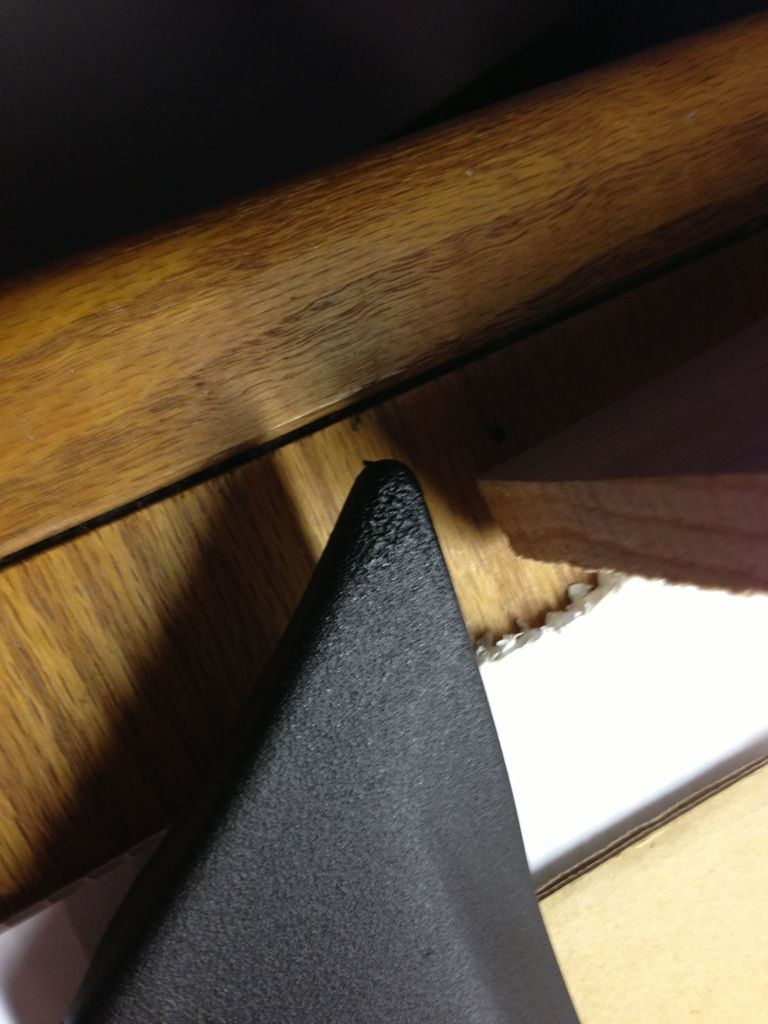

    Clumped a little on the corner.
    I have not installed it on the car yet, but I will get some pics up ass soon as I do.

    Thanks, I'm afraid its gonna make my paint look terrible lol.

    That's good to know, thanks. I was actually going for rough look. It kinda gives what I think the OEM look was. I'm gonna do the bumper trim as well.

    I love that textured look!
