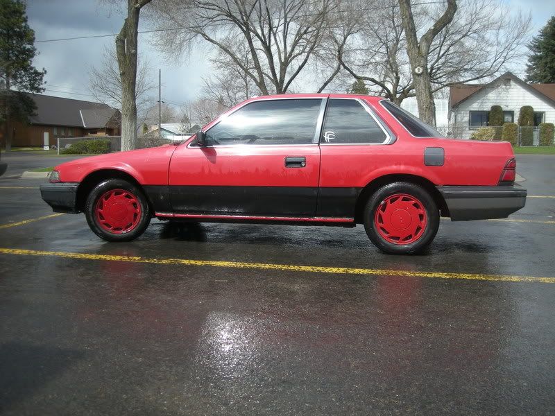

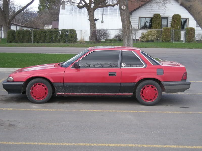

    Since the strut gets fatter the bolt was hitting the strut and not allowing it go it correctly. so I jacked the car back up till the strut backed out of the pinch fork, screwd the bolt in, set the car back down and tightend it on the ground.
    Pfft you dont need to drive it to take pictures of it
    I dont know if you can tell the difference in this before and after pic. but it is only 1/2 which is just fine for me.
    Before
    After
    The car still rides the same and it does sit even with the rear.

    very nice pico...now we are twins

    Jesus christ I love your car pico. So clean.
    Looks like it did the trick, not too intense but really makes a difference. I will definitely be doing this for my car.

    Photo shoot time for us... Thanks messy
    Thanks Cody.
    I like the way it's sitting now.
