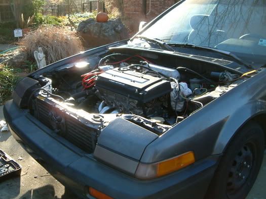

    heres a couple of update pictures, I will keep you up to date on the progress.

    Thats lookin real sick man... Props

    oh man, so jealous
    That's going to be sick

    Nice. I wish I would have rebuilt mine before I put it in.

    I hope I rebuilt it right
