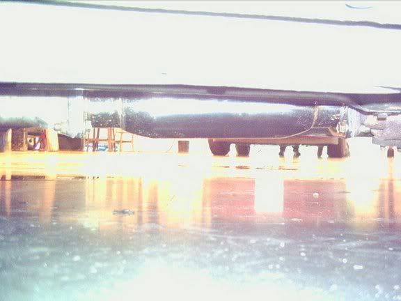

    2.0Si User
    May 2004
    1988 Accord DX
    SEMO
    3,510
    I've been working on it all week. I put the cat on. It doesn't exactly line up with the holes, must be off about 3/4" or so. It is also about 1" too freakin long. I wedged it up in there anyway. I had to heat up my exhaust pipe with a torch (cherry bomb) & twist it to get some of the bind out from the cat. That is some old school trick there.
    The fuel filter by the gas tank needs some better hose clamps, leaks. I tie a loaf of bread tighter with a twisty tie - than them things for hose clamps Honda is using. The 02 sensor wasn't bad getting off. I had an 02 socket with a (bolt type) head on it, squeezed an open end wrench through the bottom on it (1 5/8") & broke it loose.
    The PVC valve broke off in there, had to chip it out to put the new one in.
    I got the (old) carburetor off & I can't get the EFE plate loose from the intake manifold. I want to take the plate off to put a new gasket underneath it. I got to see about what I'm going to do about it tomm.

    Here is the carb. & cat installed. Carb is not done.
