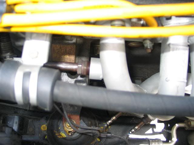

    Yet another one of those sputtering problems
    This is bugging me to death.
    I am around 164k on the odo right now. I did a tuneup about 161k after the car went to shit hesitating. I just went too far with the cap/rotor/sparkplugs. Anyways, fixed that and everything is normal. I don't remember when I changed my fuel filter but it wasn't too long ago.
    About a week ago, I was driving and the car wouldn't accelerate while moving without the sound of sputtering. The car would hesitate to accelerate and then around 3-4k rpm it would just return to normal. I've been driving for probably an hour or two. Also, I've tried to duplicate the problem and it has happened once or twice. I swapped the o2 sensors for the dc sports header (green to white and white to green) before this problem started and when I reverted it back (white to white and green to green) it sputtered even more. I kept it in the switch (Green to white, white to green) and it seems to operate normal most of the time. The car seems to feel sluggish but runs smoothly. this can be a false statement as I've driven many cars and its hard to compare what the accord is supposed to feel like after going through so many cars with more power.
    Here is what I have done recently to the car before this sputtering happened.
    -installed dc sports header
    -installed shifter bushings
    -realigned header flexpipe so it wouldn't scrape on my driveway
    *note* I didn't change the gaskets on the downpipe, or cat.
    That is a total of 3 times the dc sports header has been removed from the cat. Also, one of the studs coming out of the head where the exhaust manifold bolts onto, snapped into two. (the one on top of the EGR)
    I know this should be fixed., (the bolt has been ordered)
    Questions:
    does anyone know what my problem is?
    possibilites right now from what I've read are thermostat, o2 sensors and perhaps something to do with fuel filter, tuneup
    any ideas?
    thanks guys.

    any codes? when it sputters, does the pgmfi light come on?
    hmm, almost sounds like a timing problem but it could have something to do with fuel like you said. have you checked your timing? have you checked your plugs?
    maybe inspect your wires too and make sure you didn't toast one on the header somewhere.
