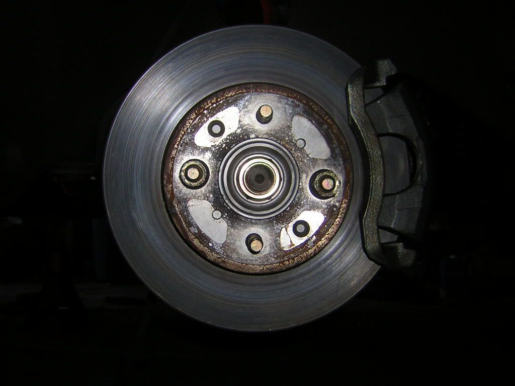

    WHAT YOU NEED:
    1) Calipers from any Sterling ('87-'90). Sterlings were ugly luxury cars with acura v6 engines in them. they are kind of rare but you can usually find at least one in the honda section of a pick-n-pull.
    2) Rotors from any Sterling or 1st gen Acura Legend excluding the 86/87 sedans. I would recommend the Legend rotors as they are easier to purchase and are avaliable slotted. THE ROTORS WILL NEED TO BE RE-DRILLED TO THE 4x100 PATTERN.
    and that's it. everything bolts right up into place and fits perfectly. use the accord caliper bracket bolts as the sterlings are too long. the only downside to this setup is you must use sterling pads which are expensive since they don't make a whole lot of them. here's some pics, sorry they're dark:

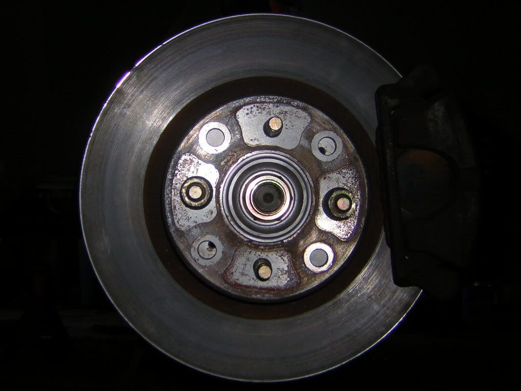

    stock lx-i
    with re-drilled sterling rotors and sterling calipers
    thanks to old blue accord for all his help with brake part documents

    what bolt pattern? if these are 4x114, then i'd bet that we can hub swap and get what we need so that we don't have to redrill the rotors every time we need to replace them. this would only be benificial if you're eating up rotors, say if you're racing the car. a little machining, and you have yourself a 4x14 hub. you'd have to get new wheels, but then you can use the wheels off of 4th-6th gen accords.

    yeah, you could probably swap a hub and use dual pattern wheels or something. as a matter of a fact, i'm pretty sure you could swap the entire front suspension from a 1g legend if you wanted.
    this is just the quickest and easiest way that found to get bigger brakes. rotors should last a long time if you buy good ones and break in your pads correctly.

    well as you might guess from how rusty/dirty the parts in the pics are, this was just a test to show that the parts would fit. i probably won't be trying it myself any time soon because i already dumped a bunch of money on oem sized brake parts before i began this project.
    i imagine there might be more pedal travel due to what appears to be a slightly larger piston but it's hard to tell by just looking at it. next time i'm at the junkyard i will check to see what size the sterling master cylinder is.
