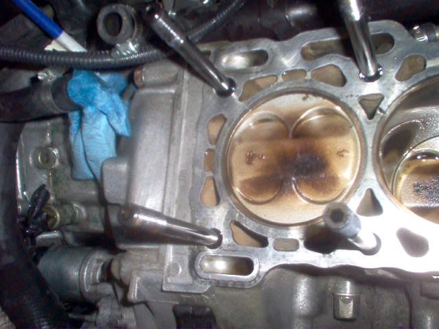

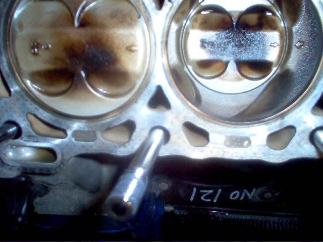

nice. on preludepower.com a guy tried installed CTR pistons in his B20A, and ended up burning oil like crazy. he had no idea why. at first he thought it was the rings, or he honed it wrong, but I don't think so.
there was seriously oil all over the tops of his pistons when he pulled the head off.
here's the pics: (at 1200 miles on the new motor)

[QUOTE=racerx]nice. on preludepower.com a guy tried installed CTR pistons in his B20A, and ended up burning oil like crazy. he had no idea why. at first he thought it was the rings, or he honed it wrong, but I don't think so.
you answered the question "he honed it wrong" owner said it himself. Unless he owns a machine shop dinggle ball hones are for Chevy's. rings never seated or pistons are too loose or the bores are tapered. Id laugh if it was mouncyn.

so, I need to know a little more about honing. I have one of those tools you can get from sears. It has 3 arms with little stones on the ends. Is one of those ok?
www.stein-photo.com
born to XLR8
well for myself no its not. There no way for me to hold a drill steady enough and keep the speed up and down in the bore uniform enough to give the proper cross hatch/taper etc. Like i said and old chevy 350 pos that you just throwing rings into, go ahead it will break the glaze help the old cheap cast iron rings break in. it be good for another 10k miles if Im lucky.Originally Posted by racerx
Try and find a good machine shop and ask them to look at or watch them bore/hone a block so it will be easier for you to understand the operation. Sunnen I think is the machine most top shops use dont quote me on that.
Remember you want the taper(top to bottom measurement) of the bore to be nil. Like that website says hes going as close as .0005 of an inch taper. A human hair is .005 (five thousandths of an inch. Hes talking 5 tenthousandths of an inch). Thats pretty damn tight.
Myself I have a engine machine shop do the work with the pistons and rings in there grubby hands so they can match the bore to the pistons with the final hone pass.

well cant seem to edit my post
but looking at those pictures again I can see an arrow reflection in the bore so that tells me right off the cross hatch is wrong. Look at your stock Honda block the cross hatch in the bore is what you want to achieve unless you ring manufacture specifies something else.

(that wasn't my engine, thank god! but he did a few things wrong when he installed those pistons)
Anyway, I've seen these honer's with 100 little balls on the ends. Would that be better? Anyone have one or used one?
