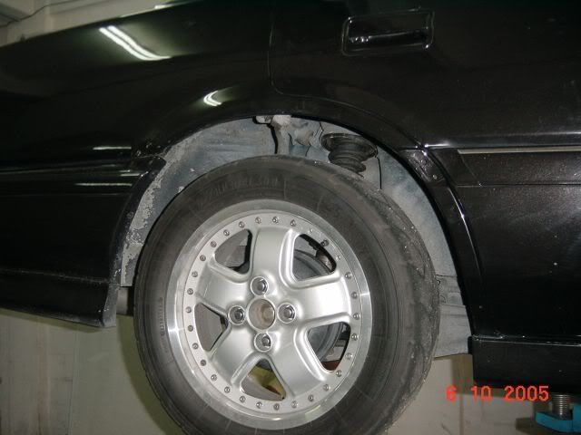

emmm looks very good...but may i ask what is it that you need to modify to fit them suspensions mate?cos if im not mistaken...front suspension taken from 1988-1991 civics are a straight fit onto our 3g....only the rear is different...height is also good without having to change much...thats wat i use last time....of cos until i got my hands on another ghetto project....ive managed to plonk in a set of Apexi World Sport Hi/Lo from a civic EG into the accord...it was hell....i got them for free...so tot of doing another round of RnD'ing on it...

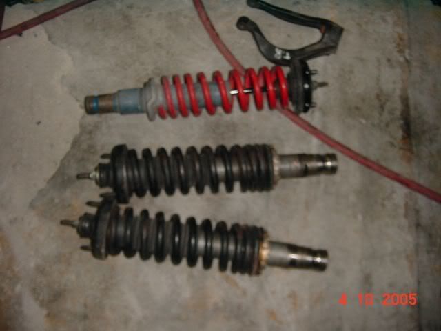

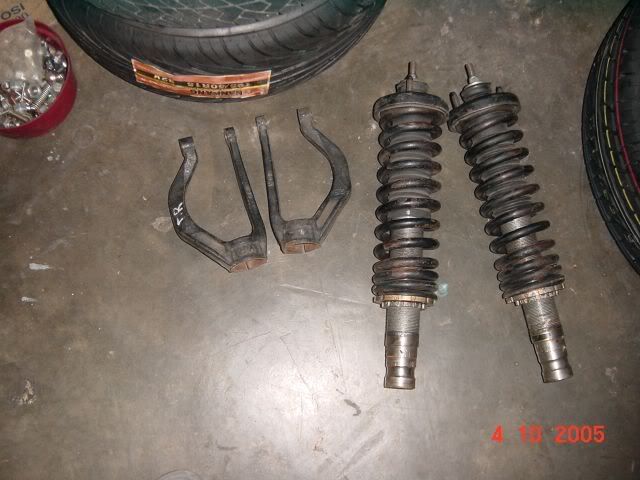

First off...to fit the front EG suspension..you'll need to get the front EG 'dunno what they call em forks'....at rough comparison...they looked the same...until i tried fitting them on...it's slightly smaller compared to ours...so i have to grind them off a bit to make space....
difference between the Apexi World Sport and Bilstein meant for the 1988/91 civic...the bilstein was changed to a shorter spring to lower my ride height summore...

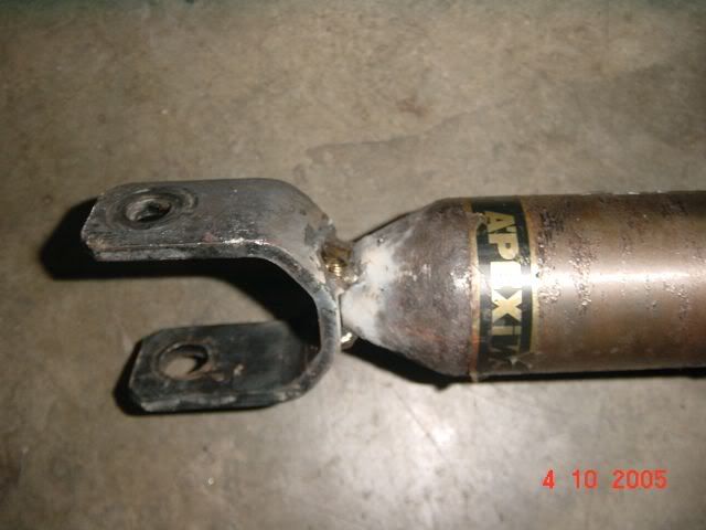

grinded to specification....yes it looked a bit unsafe isnt it....

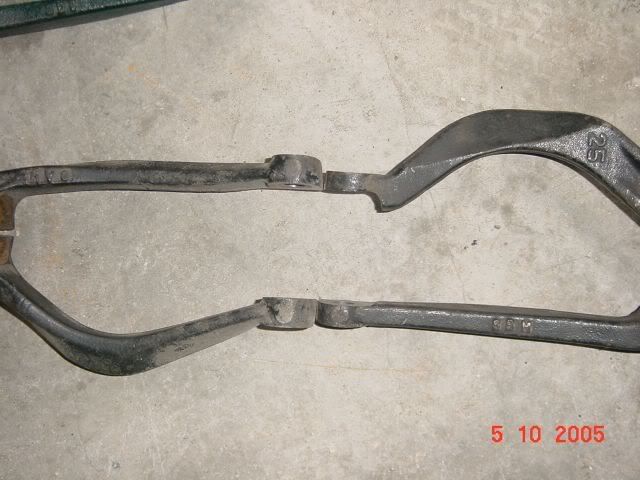

the front is ok...the back you'll need to modify the bracket...EG uses the slot in while ours uses the fork design...pics was after the transplant...notice that only EG/Integra uses the slot in design...Civic EK is a direct fit to 3G's...tried them...now dont be scared...almost all absorbers are welded too...ive made sure they did a good job on it...dun want to risk my life and the cars....hehe

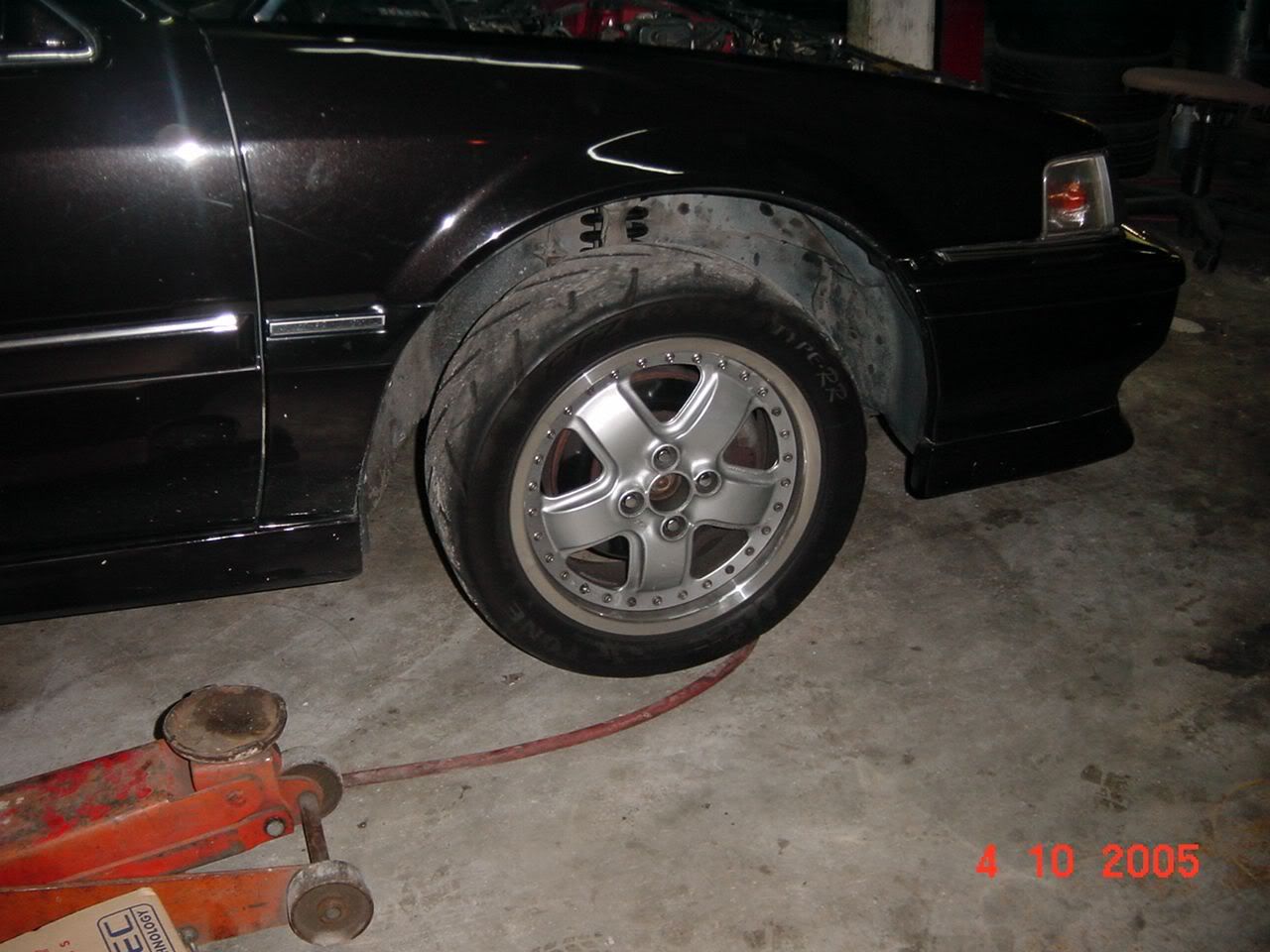

the back was excellent...the Apexi gave a short stroke impression...now my car tend to move on tripod mode ehhehehe....good damping...i can now carry passengers at the back without scraping till kingdom comes....
but look at the front...the absorbers was set at the lowest mark possible...and it still gives this big of a gap....at the end...i have to regrind the inner cup where the bottom absorbers tucked in to make them sit lower...i think most 3g modifiers know the drill rite....but if you are able to get a short stroke suspension instead...i think you wont run into this sort of height issues...i really think so myself...perhaps on the next RnD![]()

But at the end of the day...i dont feel safe in driving with the modified forks...so i decided to chuck it away and reinstall my bilstein...but keep the rear apexi...it was a lot of works needed to be done...ive sweat half my obese body off....and it didnt really works to my preference....![]()
To sum up...according to my RnD...the best combination for a cheap bang for buck suspension setup would be 1988 - 1991 Civics for the front and 1995 - 2000 Civics for the rear...you can also fit in civic EK's for the front if it's a short stroke types....at the end of the day....all i got was afrom my tuner....2006 will be the year i get a proper custom coilovers....eheheheh
