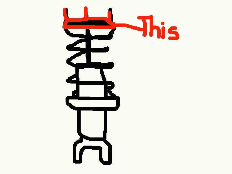

    Well the best way to explain is with a picture, LOL. Get three top hats (The red thing in my picture) and place two more on top of it. I would have to remove the bolts of the two that I place on there and I might have to get longer bolts for the one that bolts to the car. It is going to take some R&D, but I will make it work.

    964

    btw, this is the sickess draw i've ever saw!!! lololol

    Thanks that will help alot, and make sure to get the top hat for an accord and not a civic. I drew the picture so well I thought it was real .
