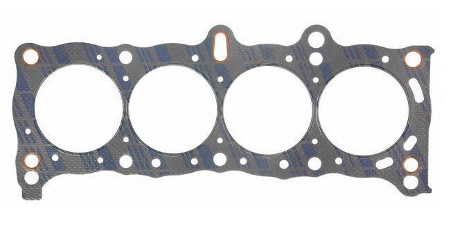

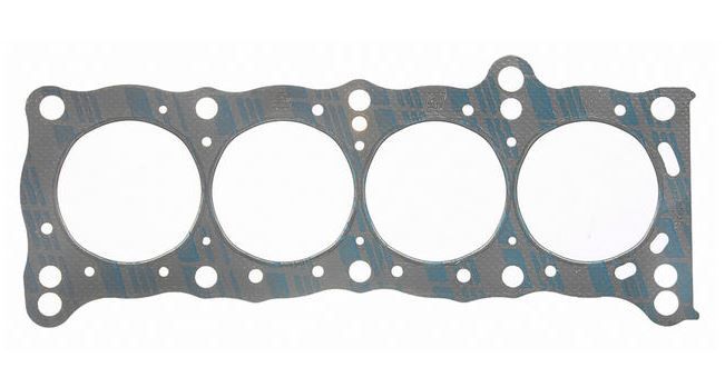

    You cannot use an A20 head on your block. The block refresh during the transition from E series to A series had one dramatic change to oiling passages and can bee seen by comparing the two head gaskets.
    E style:
    A Style:
    You can see that "E" style heads have only one main "hump" along the back of the block, but "A" style (BS & BT [and very late ET2] are "A" style) heads have two.
