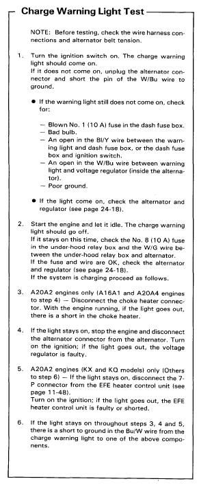

    For your alternator, you should do the charge test
    but if you know for sure that its the alternator, hope this helps

    Thanks so much for the advice and diagrams. They helped alot. I was able to slip the alternator out through the passenger side after removing the heater hose. This also seemed to fix my brake light problem.
