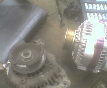

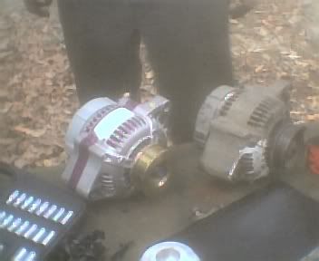

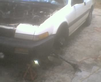

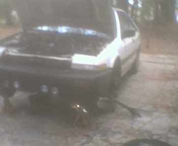

    Damn Tim, looks like you yanked out the motor too. Maybe it is just the dark pic.
    Edit- alternator is a bitch to change, have to pull some of the suspension out.
    Re: no words needed stupid alternator and transmission seals

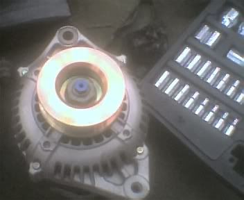

    nope,checked,it's still in there,might have been a little eaisier. I wonder who the genius at honda was who decided to make the alternator come out from the bottom. I forgot what a pain this was,haven't done this since 2002, that old one looks like it was in a bar fight and lost. this job pretty much made my day go down the . even a rain delay,went from 70 degrees and sunny to freezing ass cold and rainy.
    its gold!!!!!!

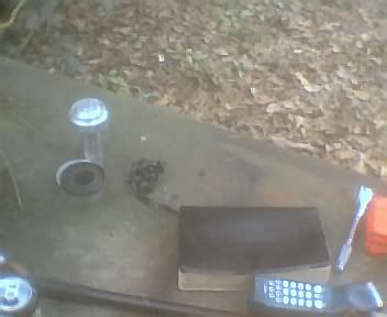

    the seal for the driveshaft was leaking too,so the driveshaft came out,had to drain the transmission,and the freaking crossmember had to come out,I had made some special drivers for putting those seals in,but they still wouldn't drive in right,tok about four tries.

    Thanks for the headsup. I have both seals for the half-shafts to put in, along with new C-clips. I was wondering what I'm going to drive them in with. I'm thinking something along the lines of a pretty big socket to fit the diameter. Hopefully something will work.

    nice shirt....and rockin da gold altinator yo...lol

    $500 4 machanics 2 change it?!?!?!? wtf! could buy another car for dat price, or just buy a *proper* socket for it and change it yourself, and you can get the alt out thru the top on a carbed engine, it aint that hard, just need 6 point sockets, or you'll end up like my alt bolt, you dont needa take off anything to get it out either, but yet again you have a LHD so that will prolly be alot different. btw, very very nice shiney golden alt there
    you can get one of those seal driver sets with the steped drivers,that should work,and fit other seals too. it just holds the seal straight while you drive it in. I had made a set for the left and right transmission seals. remember the right side seal is a lot bigger then the left so i'm not sure if they make a driver to fit. it's a lot eaisier to get to though,so you might be able to tap it in. the left side has the cross member in the way which can be unbolted,and the exaust pipe in the way,if you have a driver with a long shaft you can tap it in from the oposite side of the pipe. what I did was put the driver in place then put a long piece of pipe on it and my wife hit the other end of the pipe with a hammer.

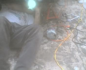

    your master cyl and booster,also your brake lines going to it are on the opposite side. thats mostly what gets in the way. on these carbed cars the alternator can't go up,sideways in eithier direction,only straight down,which happens to be occupied by the same space as the cv axle. last time I had to replace it I tried everything possible to get it out without removing the axle. even removing the pulley while it was still in the car,just won't go. also the lower alt bracket has to come out because it's in the way before the alternator will come out. of course I had loctited it in,like I do everything else,real fun to get loose. OH the alternator is just a stock replacment nappa unit,I do like the gold anodized pulley though.

    For the seals, I usually use the old seal as a driver to install the new one. You can hammer it in with a rubber mallet and you don't rink damaging the new seal this way.
