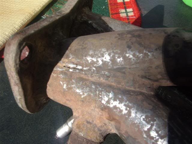

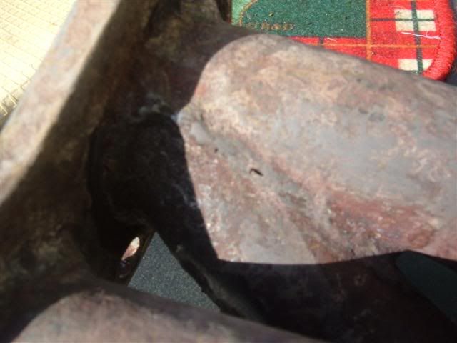

    i learned the hard way. i got them from a member here on.
    that is when i got them
    that is what i found after i cleaned them with 120 grit sand paper. they crack...i call the company since they have 3 year warranty but since i dont have a copy of a receipt..... IF ANY ONE HAS ONE CAN I GET A COPY AND I WILL PHOTOSHOP MY REAL DATE...il give you 3 bucks also via paypal

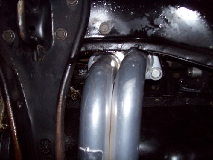

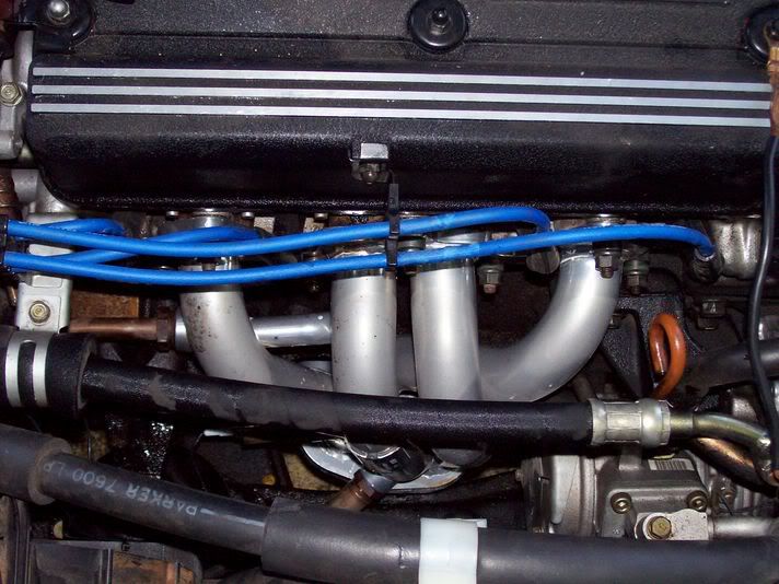

    I can give a thumb's up to JetHot. JetHot will sell you the Pacesetter WITH their coating on the headers, downtube, pipe, et al. BTW, I kept the joint, never got a flex pipe, and I've never had a problem. I did have to nick away a SMALL part of my crossmember so it wouldn't vibrate against the pipe, but that took about 5 min. at the muffler shop.
    http://www.jet-hot.com/Pages/why.html
    Your headers will look like crap if you don't coat them; don't waste your time/money on high-temp paint. Why spend all that money on your rebuild only to have your exhaust ruin it?
    This pic shows where my muffler man cut out a small section of the crossmember so it wouldn't vibrate.
    Here's the joint that comes w/ the Pacesetter that some people replace w/ a flex pipe. I've had ZERO problems with the joint, so far.
    Here's what the JetHot coating looks like. They coat all 3 pieces.
