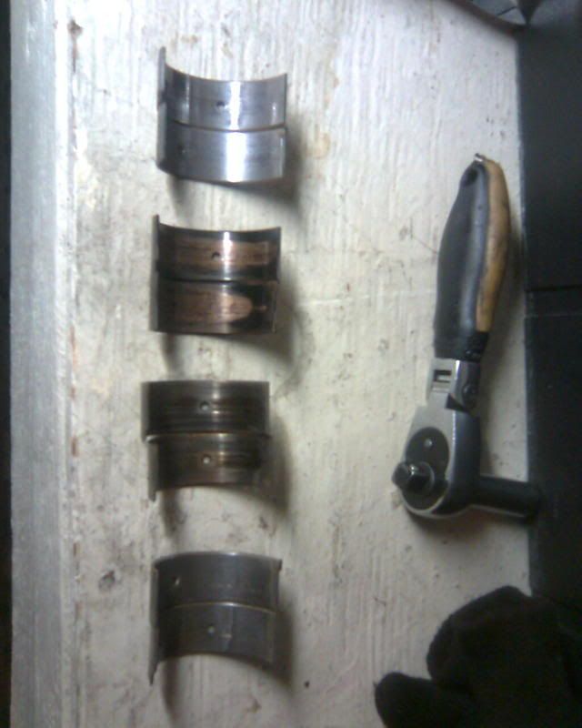

    heres a pic of the bearings... im no mad scientist but i know these are gone.. am i right?

    Pic no work...

    sorry guys.. upload took a while.. i got the pic up now on my first post.. what do you guys think?

    Re: spun bearings?
    Quote Originally Posted by 1987AccordLx-i View Post
    Yes

    Re: spun bearings?
    ok so for sure these are gone.. how much would a set of these cost me? someone told me about 30 bucks for a set..
    and another thing... would i have to resurface the crank or do something to it? it has faint indications of scratch marks.. idk if that would affect the new bearings

    It all depends on how deep the scratches go, if the crank could be reground then you would just use a thicker set of bearings to take up the difference.

    Re: spun bearings?
    Quote Originally Posted by nswst8 View Post
    well the crank doesnt have any "feelable" scratches but visual there is some..

    Re: spun bearings?
    Then I would just pick up some new bearings and install.

    Re: spun bearings?
    Some slight scratches on the crank are probably ok unless you can feel them. You could also take to to a machine shop and ask what they think.

    Re: spun bearings?
    Looks like somebody already patched it once, better have the crank checked.
    that second one looks like really dirty oil or no oil, for a good while.

    Re: spun bearings?
    Definitely have a shop look at the crank regardless. Worst case, it can probably be just polished out. I would avoid grinding the crank, as I hear that you'll grind off the hardened surface that make the Honda cranks so wonderful. Another A20 crank can't be that expensive, especially seeing how there are like 138741309483194834 of them.

    Re: spun bearings?
    Well at the very least you want the correct size bearings on each crank journel. So the bearings you buy you need to use pasti guage and check the clearance on each bearing.
    If the scratches don't catch a finger nail then I would just use very fine crokus cloth and polish the crank best you can.
    Big thing is to find out why they wore out in the first place. Oil pressure would be my first check. Might want to replace the oil pump anyway alot of that bearing trash prolly went thru the pump.

    Truer words were never spoken. Get ahold of the sizes the crank journals are supposed to be, and have someone with a micrometer measure them, in several direction. If the journals are still within the size tolerance, are not egged out or tapered, give them a light polish and re-install, using plastigauge as mentioned above. Also a good idea to have the rods checked for out of round, and re-sized if needed. An out of round rod won't hold the bearing shells properly, and the clearances won't be right.
    Edit: BTW those bearings aren't spun, like the thread title indicates. Spun bearings occur when the bearing welds to the crank, and spins in the housing, mangling everything.

    Re: spun bearings?
    Quote Originally Posted by guyhatesmycar View Post
    well the crank has little... i would say microgrooves.. and i talked to a shop and they said as long as the grooves dont hit the bearings.. they will just fill up with oil and that wont bother the bearings.. hmm.. so this would just be worn bearings?
