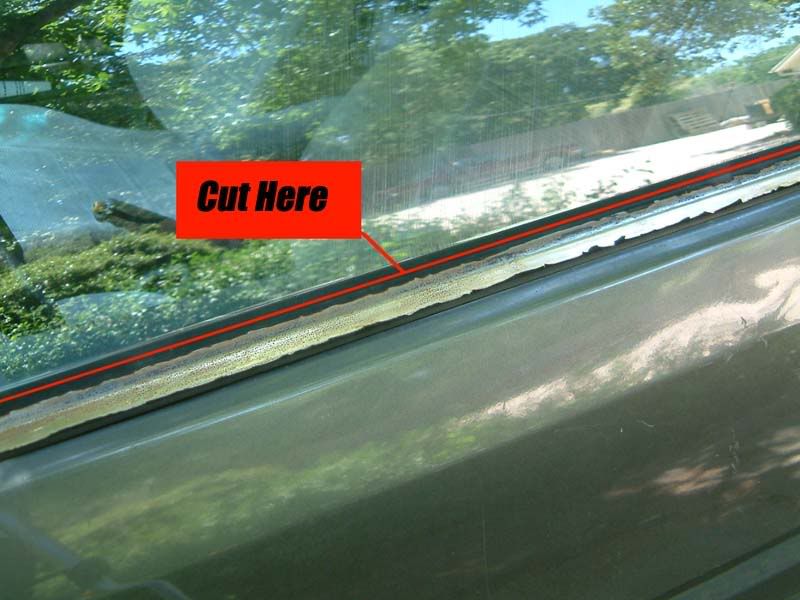

    I began by cutting the extra black rubber off the window trim.

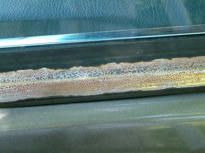

    Then I used sandpaper to remove the rust on the metal part of the trim.
    I cleaned the area with soap and water then dried it thoroughly.

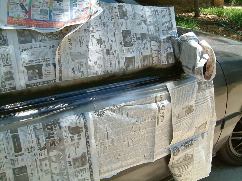

    Then I taped off the area I wanted to paint (use newspaper to cover the larger areas), and began to paint.

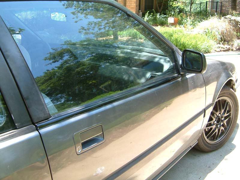

    and a couple pics of the finished product.

    Just a couple tips from a hobby level car painter....
    • NEVER use Duct Tape for a masking tape. It leaves behind residue and adhesives. Get you some decent Scotch Brand Painter's Masking Tape from Lowes or Home Depot or from a local Auto Paint and Body supply store.
    • NEVER use Newspaper as a mask, it's not much better than using a kleenex, paint can bleed right through that stuff. Again, find some proper masking paper like at the auto paint supply store.
    • Use a good cleaner prior to applying paint, not just soap and water. I happen to use and like DuPont Final Klean. It removes grease and wax, those nasty things that cause fisheyes. Those suck. Alot...... lol.
    • And finally, they do make actual trim paint specifically for automotive trim. Once again, a trip to the local auto paint store will score you a can. You can get it in Matte, Satin (best match for stock 3G trims), and Gloss.
    Also, if you want to see how it turns out when following these tips, check out my thread here: Door Pillar Painting..
    Not bashing your job, it looks pretty good for a first timer, just want to help you to do it a more professional way so you can be ecstatic about the results and have it last longer and really impress your friends. Just tryin to help!
