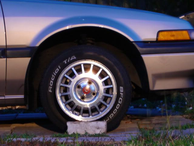

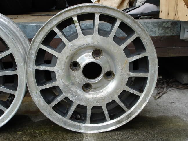

    i've been slowly getting these wheels polished out in the same manner with a rotorly tool. i just havent gotten around to finishing them all up since they were so deteriorated from oxidation. lots of pitting and a lot of surface to make mirror finish. i think it'll be well worth the work when they are done. nice job on the engine parts. they look really nice and well done.
