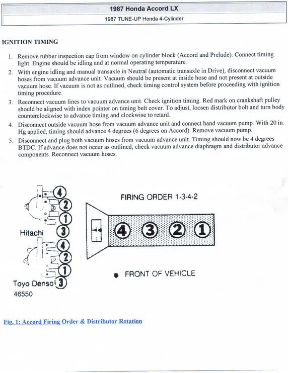

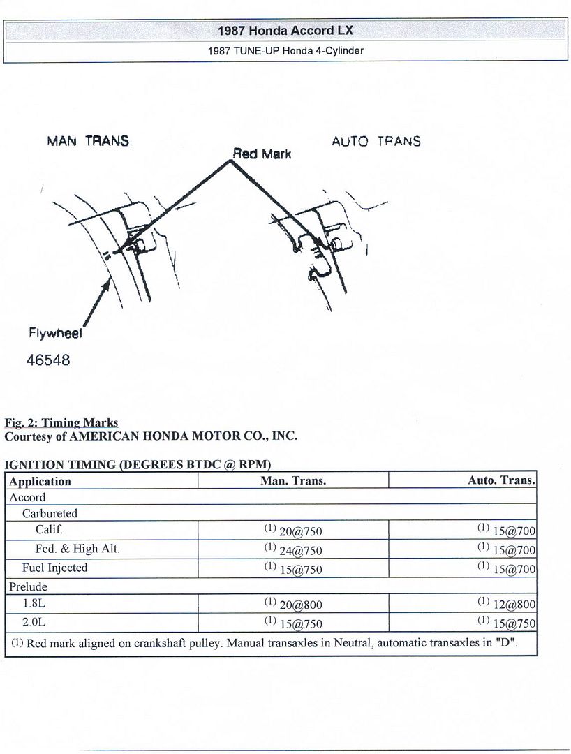

    This may sound like a dumb question, but what do you look for when you time it? because lately, mines been idling really rough and i dont think it was timed correctly when the new belt was put on...

    first off you will need a timing light, often called a timing gun. if you have that, find the hole to look through, its on the transmisson housing butted up to the engine block. usually has a rubber stopper piece put in there, or it should. anyway, once you find that hole, you know where to look through. then have your car warmed up and at idle. then you will plug the timing light on and then aim it into the hole you will look through. you will then see a timing mark. it should be set around 4 degrees if its to factory specs. mine is about 5 degrees and ran great after i set it there. you need a 10 mm socket for the 2 bolts on the distributor, and probley an extension. i did anyway. well check these notes out i got from school on it today, that would be the best thing to follow.
    http://img.photobucket.com/albums/v2...7/60cd8f93.jpg
    http://img.photobucket.com/albums/v2...7/2971347f.jpg

    awesome, thanks man, i'm gonna have to check it out tomorrow

    so anyone know where the sweet spot, if there is one, is to set the timing mark? it was a about the middle spot , then i put it closer away from 0 where its marked either 5 or 6. i dont know what to do about the pinging besides adding higher grade fuel? i'm using 87 octane.
