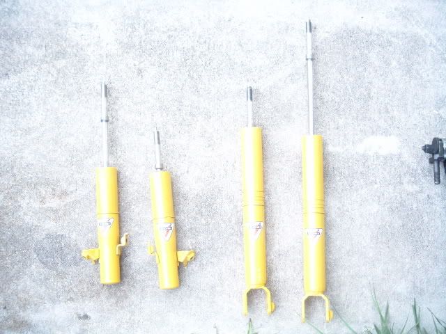

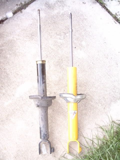

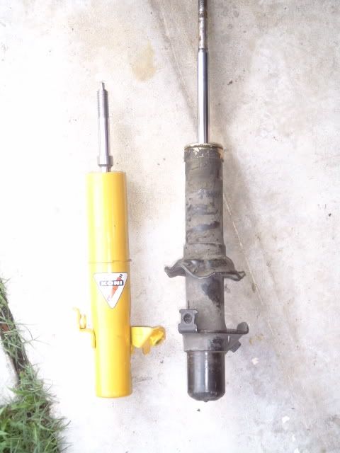

    I sent my koni reds in to koni to be revalved, made externally adjustable and shortened. Well to my surprise when they returned they were no longer red but yellow. I had also inquired about making them full bodied coilovers but they were supposed to get back to me before they shipped to see if they could make em and they never did.
    Anyway Ive driven on them for almost two years now and revalved and set to full soft they feel like the reds at 1/2 to 3/4 full dampening.
    The shortening helped alot on the front end because I no longer hit the bumpstops and have to worry about blowing them.
    Here are a couple of pics.

    no the are the sames ones I sent in. They just modified them. I guess if they did make koni yellows for the 3rd gen accord they would be just what I askedd for. Which is externally adjustable ad valved a little heavier.

    they stopped making the koni reds for us a couple of years ago. They never did offer the koni yellows for the third gen accord.
    The koni yellows are a step up from the reds in valving. So since I had mine revalved they basicly upgraded to the yellow specs and hence painted yellow.
    At least this is what I think.
    I sent in my struts about 2 years ago I'm just a little late on posting about it.
    By the way it rocks not having to take your struts appart to adjust them.

    For me it was worth it for the simple fact that Im dropped 2.25 inches which the fact they were shortened helps with dampimg. The fact they were revalved stiffer cause even when I had them at full stiff before it still felt a little loose.
    PLus the externally adjustable is definately worth it to me cause now I can set it up the way I want without taking the damn things apart.
    I just wished they would have looked into making them full bodied coilovers.
