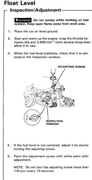

    I kinda futzed the animation... but you should get the idea.
    - llia
    Re: my final problem :D (i think)
    ahh i see now. i should be able to just cut out a gasket from just some piece of rubber and put it on right? i dont see why not....
    as for the float level, i think im understanding it, but do i have to check the float level with the car running or at warm temp or with it off? and how would i adjust it?? i want the car running the leanest possible
    I'm suposed to do that right??? and that should make the car run more lean?
    yes when it's lower it will be leaner, just be careful... you don't want to confuse bad ignition problem with a rich mixture problem... then lean out the motor and damage the motor from the lean mix.
    It'll overheat the motor and it will die.
    Your cooling system probably wont help you either... especially if it has a hard enough time keeping things cool with a normal fuel mix.
    and don't set the fuel level below those markers... find the low point inbetween them.
