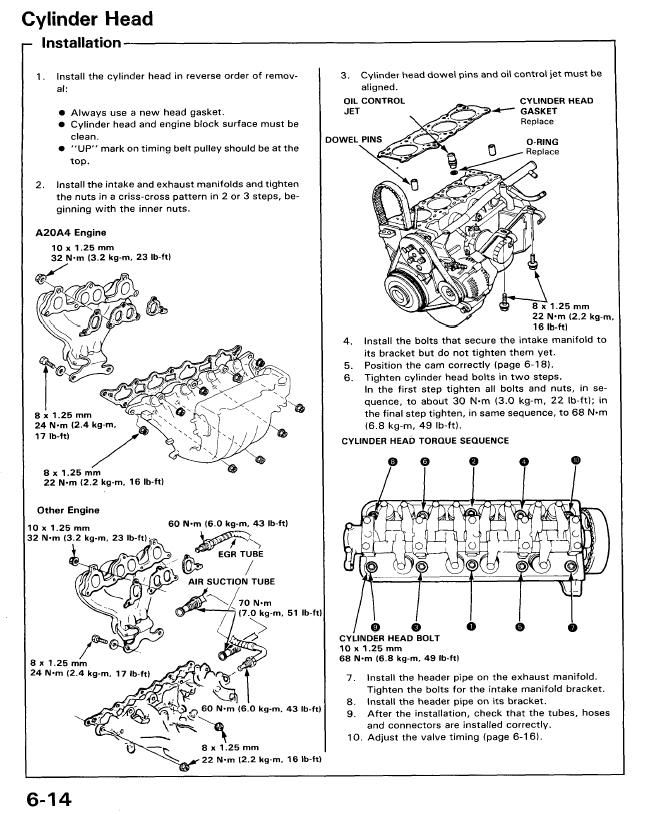

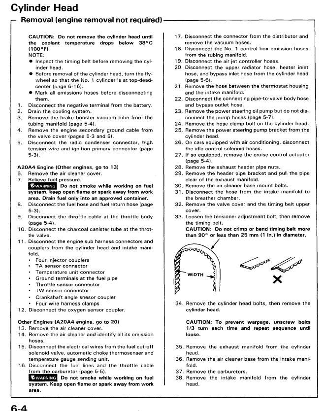

    Valve lash, hope this helps:
    valve lash 1
    valve lash 2
    edit: undoing the head bolts might be going from inside to out, or vice versa, i forgot.
