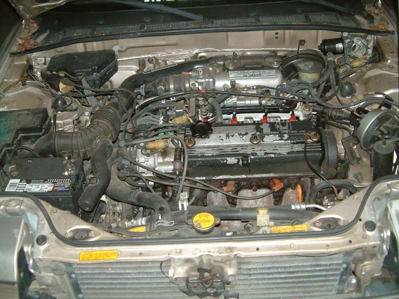

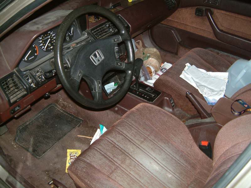

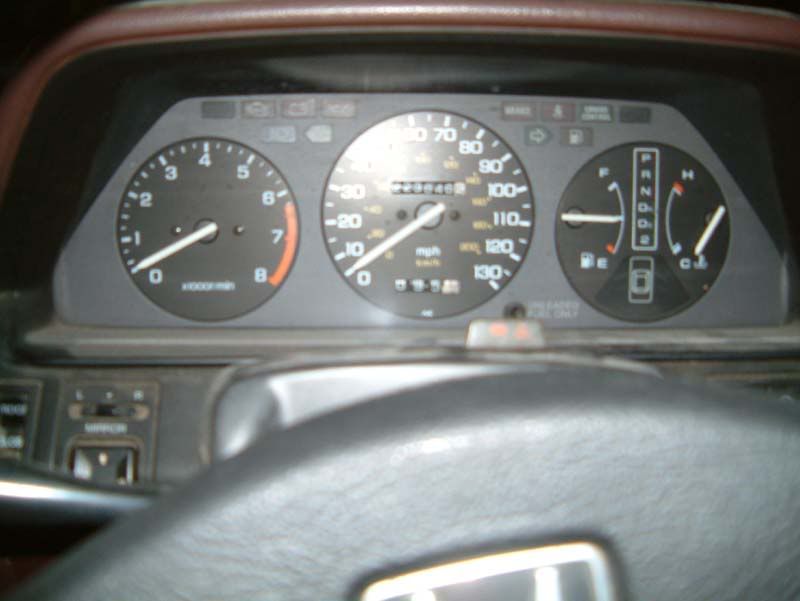

    Got my shop lined out to do the machine work on the engine. Looking at having the block and head hot tanked, having the block honed and decked, having the head rebuilt and true the surface, and then install a full rebuild kit. Should be a tight motor when I'm done. Nothing fancy, but reliable as hell with hopefully a bit more pep than it originally started with. I think I can keep this all under a grand (hopefully).
    Here are some of my pics, after the cleanup lol. I think the amount of money spent on Starbuck's coffee drank while driving this car exceeded the car's own value LMAO. Dude hope it was decaf, if not that probably explains the blown tranny!!!!
    Pic 1
    Pic 2
    Pic 3
    Pic 4
    Pic 5
    Pic 6
    Pic 7
    Pic 8
    Blue Wonder and the GSR Teg

    Re: Got my parts car tonight for the PGM-FI conversion
    LOL, if you compare my pics you can tell how well that thing cleaned up.
    LXi User RamThis's Avatar
    N. Richland Hills, Tx
    955
    LOL I accidentally clicked submit somehow before I finished my post. Yeah, it was fulla crap, a 30 gallon trash can full!!
    BTW, man, um, dont know who's jock strap and nut protector that was in the trunk but, EWWWWWW......
