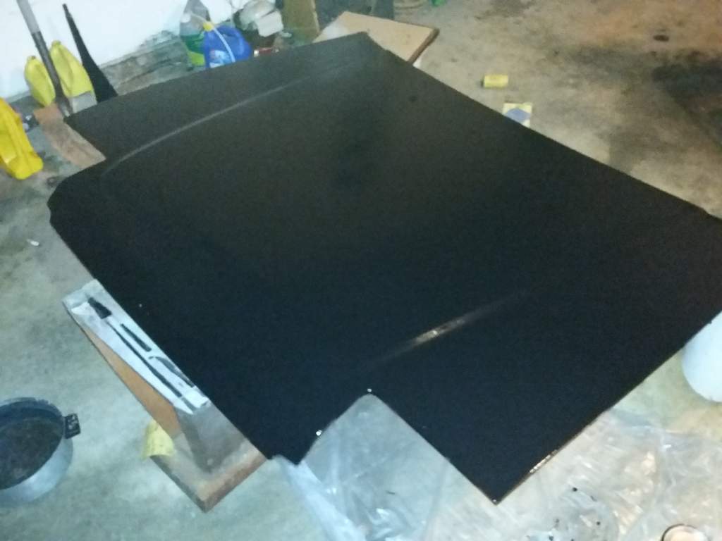

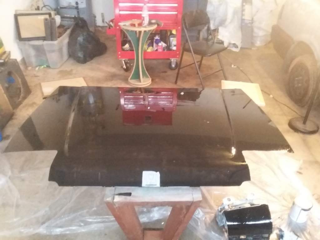

    Re: $50 paint job...dyi..and hot as hell

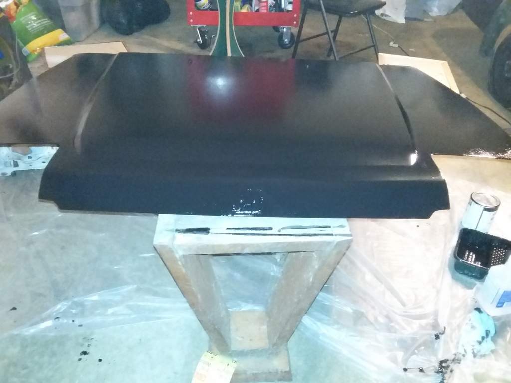

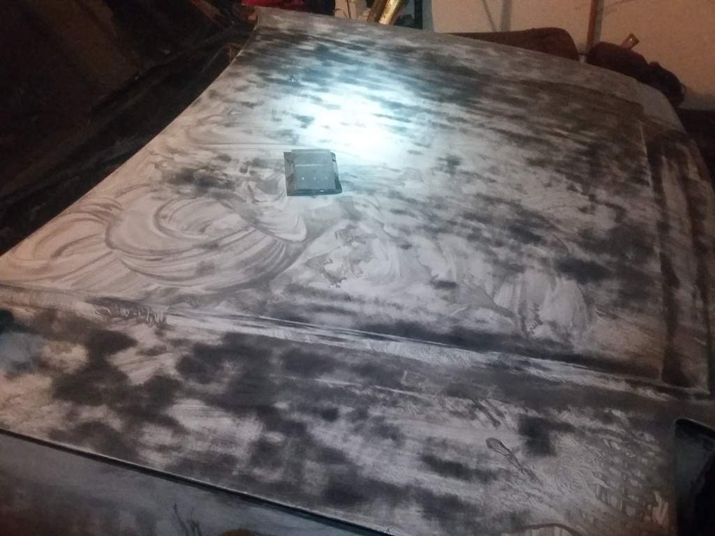

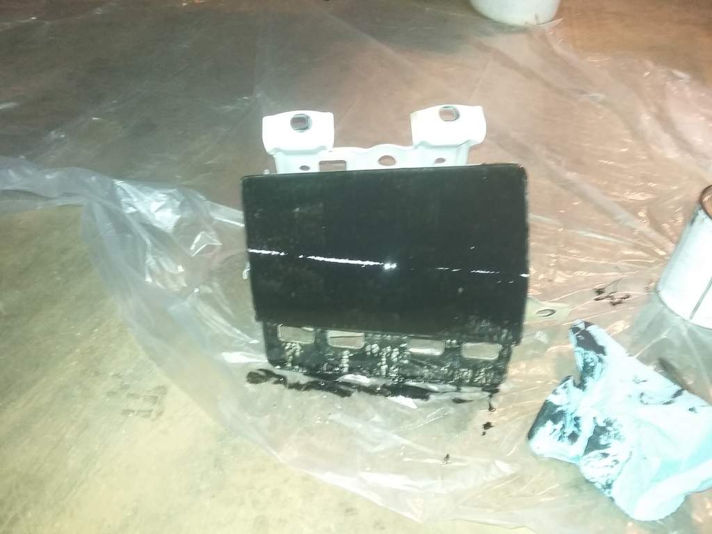

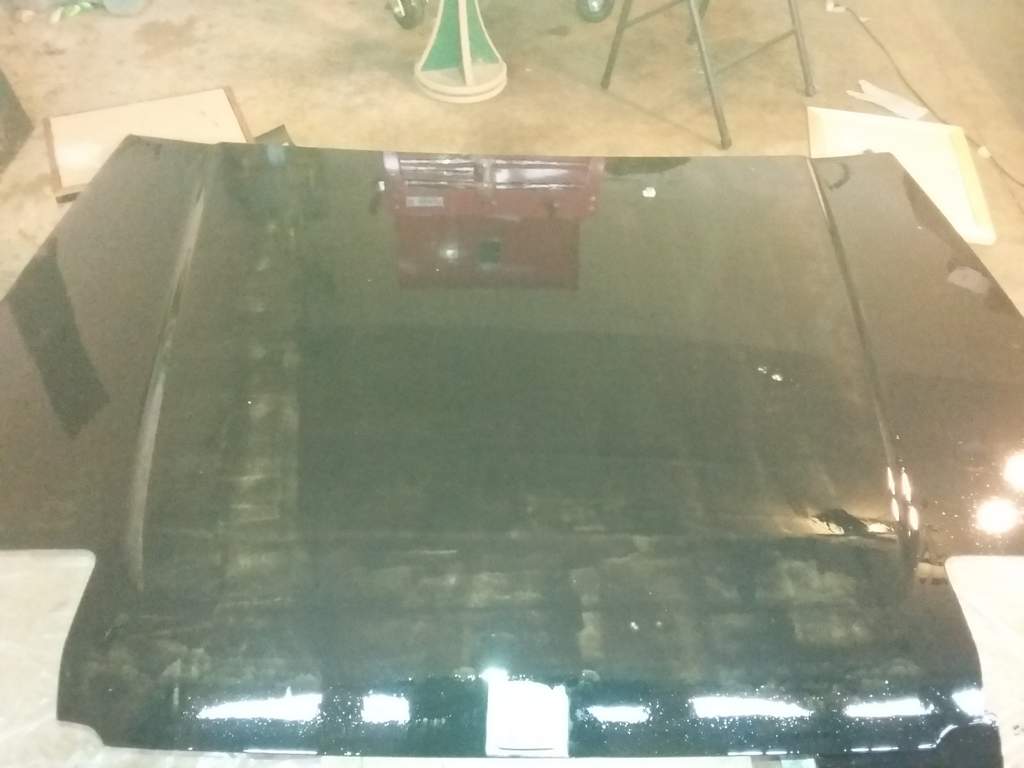

    As you can see thats only coat 2 and no wet sanding yet.... so far i have done 6 coats with no wetsanding. i let it dry to see how the finish would be... to my amazement it actually wasn't as orange peely as i thought it would be... i have more pics coming soon. also when i am done i will take sun photos to show off the paint job. this is my first time ever trying to paint a car... i will show you the materials i used and what the hood and headlight look like now that it is completely dry.... (my prep work was slacking) but even then i am highly impressed with the outcome
    i picked up everything but sandpaper at walmart of all places(paint was like 8.50/Qt) I got gloss black as you can see
    i mixed the paint to about water consistency(thinned it wil oderless mineral spirits)
    along with a high density foam roller
    hood dried after 6 coats of paint(a little orange peel and a couple spots you can see lines from roller, but once i sand it should blend it)

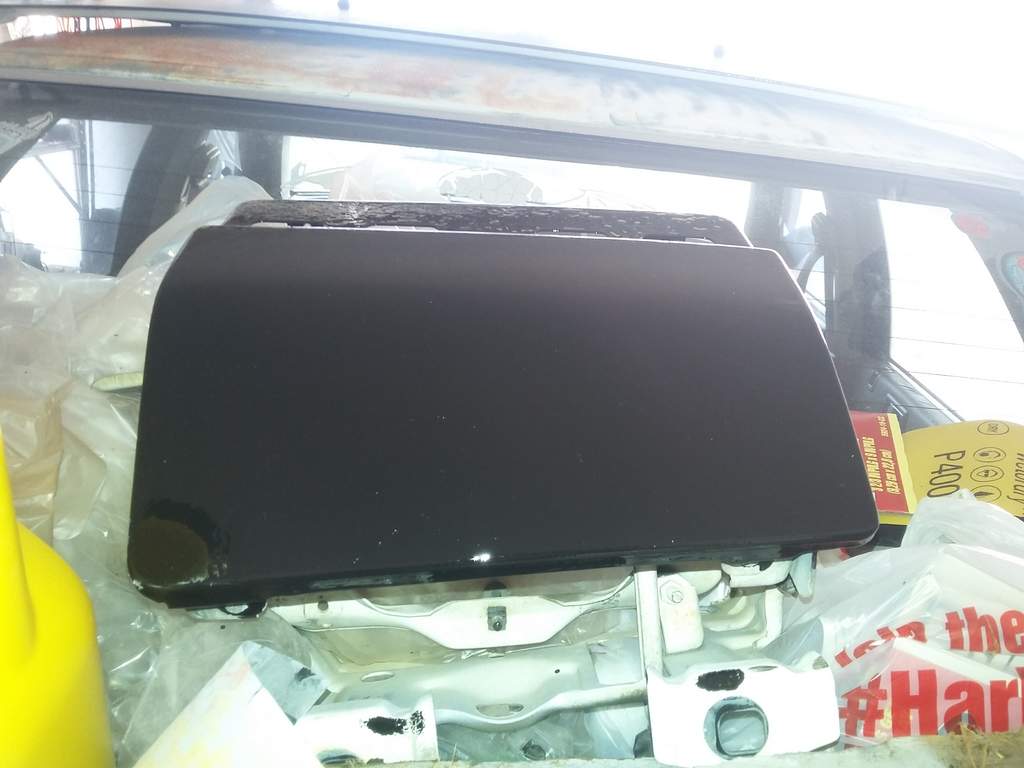

    the headlight turned out amazing with a nice glossy finish without buffingClick image for larger version.

    now granted i realize its not 3k paint job quality but for $25 i spent on hood and both headlights to get prep'd and painted and ill finish it with wet sanding 4-6 more coats and polishing compound... on a budget i doubt even the cheapest discounted paints can come close.... i wont roll the whole car like the guy in a forum i read (who gave me this technique) but i will go to harbor frieght and pick up a 30dollar gravity fed spray gun and spray using this same paint thinned out with mineral spirits..... this seems like a really decent durable alternative to automotive paint.
