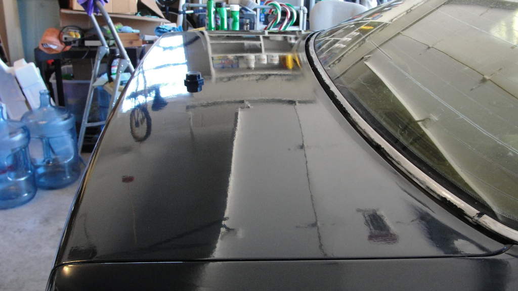

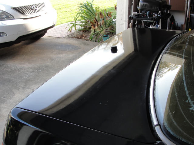

    Thanks for reply and honestly I do not expect this paint job comparable to a spray job done by a shop. I have painted about 6 to 7 layers of Rustoleum. I do remember it was more shiny right after it was painted into the next few days. Then it seems getting more hazy on the surface. Could be very well the reason you stated.
    I also think that I'm probably not using the DA polisher correctly or not having the skills. Today I did the trunk "all by hand" and I'm pleased with the result - 1000 wet sand -> 2000 wet sand -> turtle wax rubbing 2 passes -> turtle wax polishing 1 pass -> Simoniz hard shell wax (instead of lazy spray wax). The result is very good.

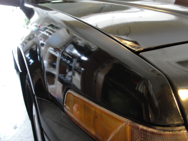

    Smile Found the recipe for buffing
    I think I found the recipe of the buffing: I still have to wet sand 1000 then 2000. Afterwards, I use Turtle wax Ice speed compound. This compound is much more liquid like milk. I put it on my DA polisher on an orange pad. Put quite a bit on the pad and let it soak in. Then buff it with slowest speed (about 1500 rpm). This way, I can do many passes over the area without it drying up like the regular TW rubbing compound. I did 3 to 4 passes. Those hard to reach area, I did it by hand. Please refer to the pics below. I have not use the scratching removal compound yet but I will.
