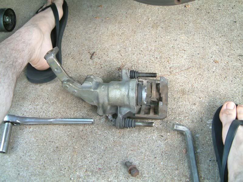

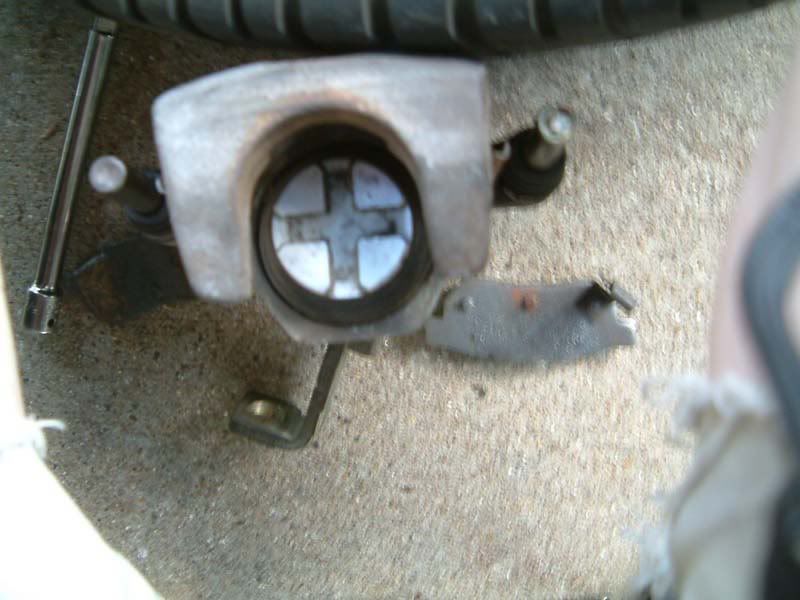

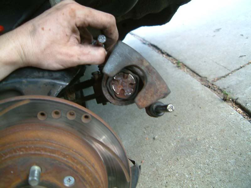

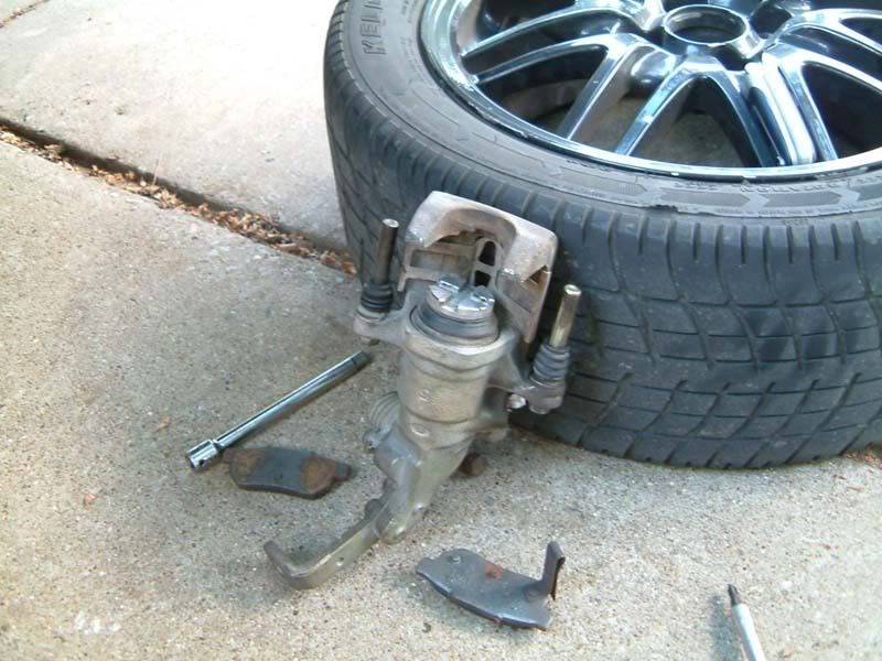

    Ok I got a little update on the caliper.
    If you are looking to upgrade your stock caliper it is very possible to do and keep using the same rotor. A little bit of shaving on the SE-i bracket is required, but you can use the legend caliper with the SE-i bracket. Grinding is required to make the piston clear the bracket and the front side of the claiper needs to clear also. here is a little pic.

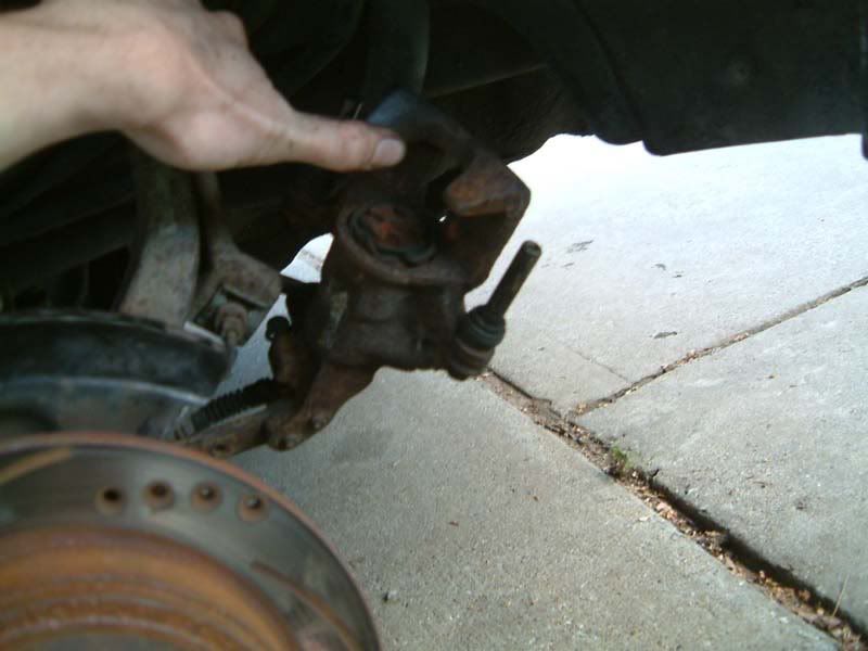

    You could also use your stock SE-i caliper with the Legend bracket, I am not sure why you would do this, but it is possible. Here is a shot of that one.

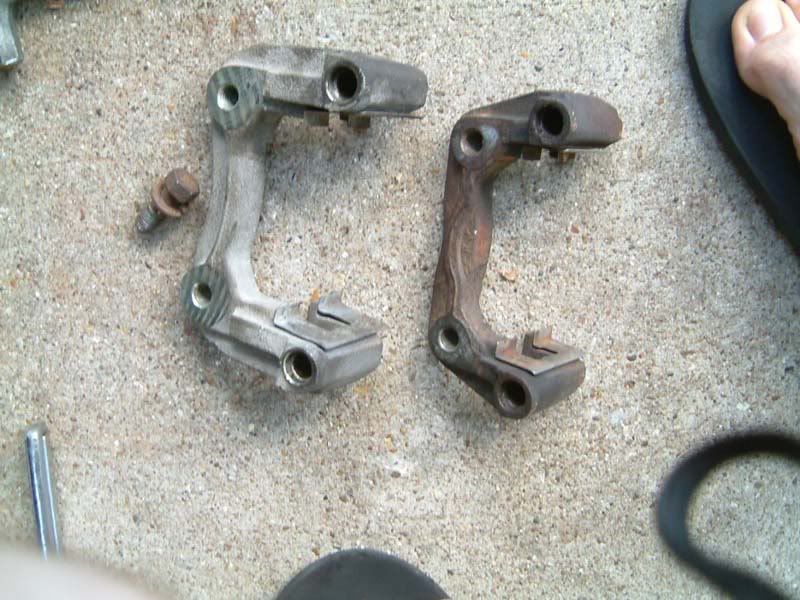

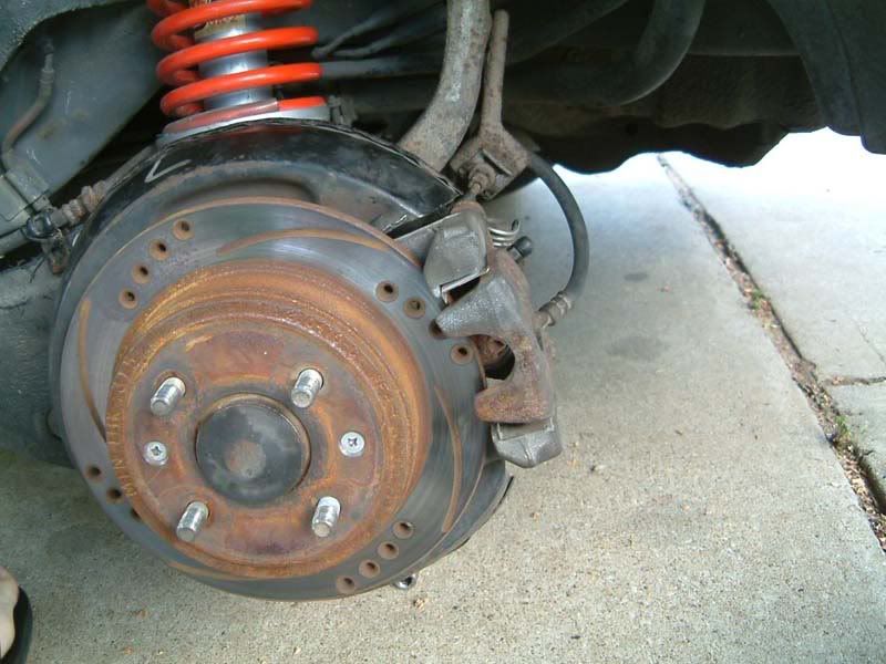

    Here are a couple more pics to show you the difference in calipers and brackets.
    Legend on the left/ SE-i on the right
    I know I have casper legs and this is the Legend Caliper size.

    Re: PROJECT: Rear Struts and Bigger brakes
    The legend caliper looks substantially bigger compared to the se-i caliper.
  7. #32
    Quote Originally Posted by Hash_man_Se_i
    They are, I just could not take a picture of them compared next to each other, because I didnt disconnect the rear SE-i caliper. That gap in the second picture is filled with pad and rotor when you bolt the legend caliper on there.
