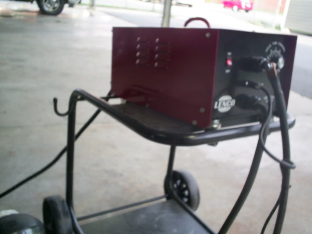

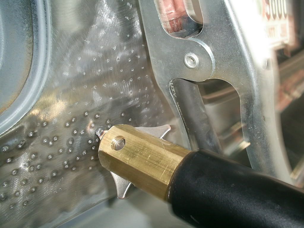

    spot weld dent puller
    puller welds to panel then slide hammer is built in,when you are done with a particular pull,you simply twist it to remove.

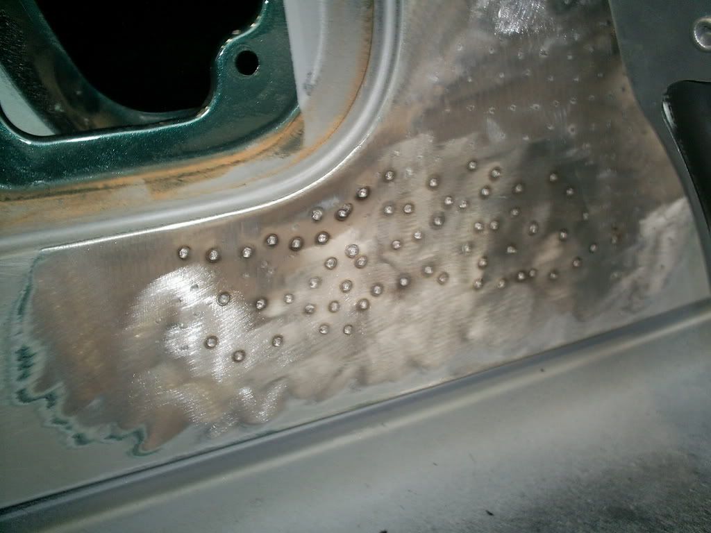

    took about 60 pulls to fix this area,still isn't finished
    almost finished,temp in primer until finished

    when you are done you clean off the small bits of metal with a 30 grit disc in a die grinder, then you can fill and finish. it leaves the metal intact. you don't have to pull the metal up perfectly, just close enough to finish with filler,also to lower the high spots,you hit it with the disc,then that highlights them, then you use the puller to hold the metal,while you hammer down the high spots with a body hammer.

    man you put alot of lil spotwelds.....i guess that is how you do it. i only used like 10 for a whole fender and just filled in the rest. hahha
    Re: 98 bodywork
    each one is a pull area, it takes a lot of little pulls to straighten it out.
    Re: 98 bodywork
    yeah i know...the more you have the more even you can pull out the dent...i was just learning back then.

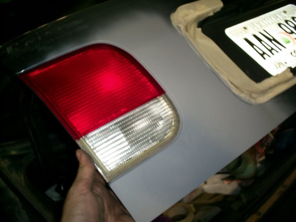

    more work on the 98,
    the temp primer has been removed,
    this is before removing the primer to highlight the high spots
    and now the high spots are hit with a body file to lower them.
    now the metal is roughed with a 60 grit disc,it's too smooth after it is hit with the body file. the scratches in the metal help hold the filler in place.
    spreading the filler
    first coat of filler showing low spots after sanding
    second coat of filler

    CAH i just fixed the last picture,you should mix and apply your filler within one to one and a half minutes,one minute is probably pushing it,in the second picture,thats what your filler should look like before you sand anything.
