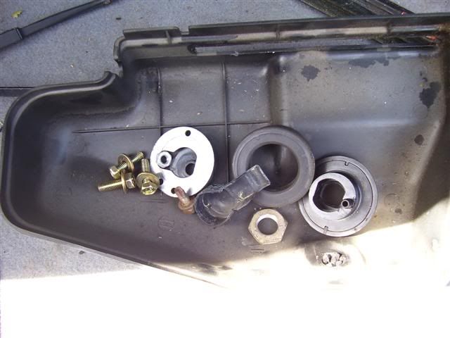

    this is for those of you who wanted 2 see the rear wiper setup

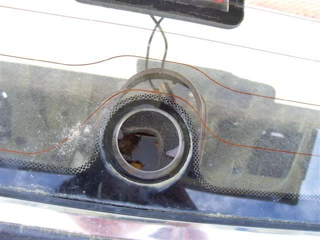

    the hole (i didnt get around to measuring the size):
    as you can see you need another window or just drill a hole and paint a orange line/pin stripe around it so it looks normal.
    the motor:

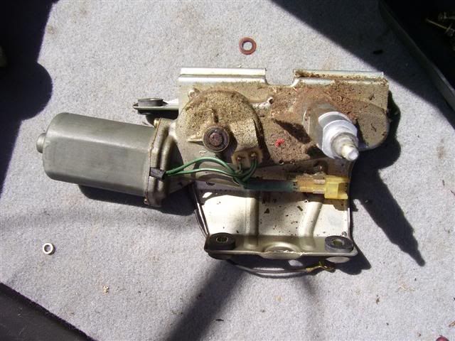

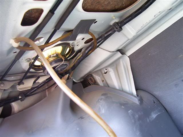

    the squirtee hose:
    just goes into the un-drilled hole in your water tank thingy up front

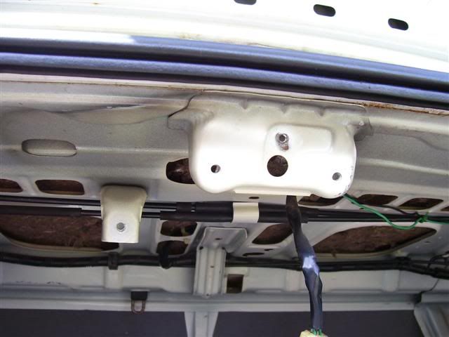

    the mounts:
    all the little pieces:

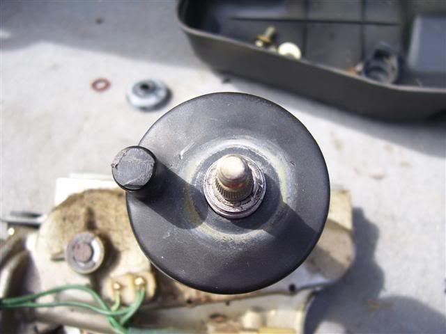

    the squirtee thingy:
    in the car:

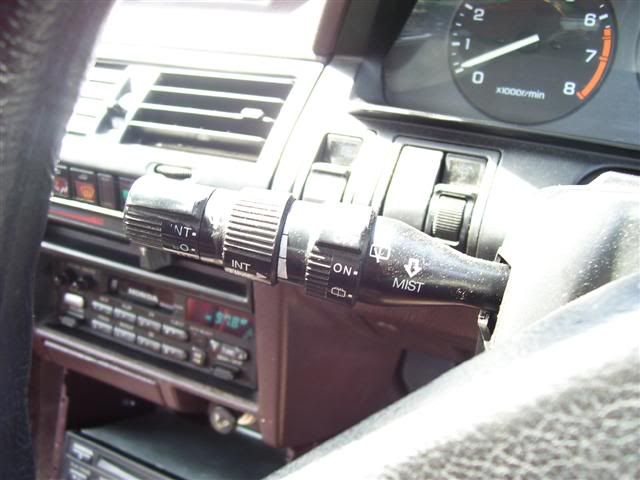

    and the combo switch:
    and i forgot to get a pic of the actual wiper itself lol but any normal rear wiper off any other car should work (mines off our barina) but some wipers might hit the squirtee thingy

    nice write up....thoes are rare here....doesnt the hatch have a rear wiper?
    Re: rear wiper setup
    ya the hatch does, dunno if its the same motor though cause then you would have a ugly ass lump sticking outta the hatch door from the inside

    hey OD how much would it cost to get all the stuff needed to do that conversion??? i truley do want it for a project i have going on that i havent started yet lol but i want to know if the option is open
    and on another note messy congrats(i guess)on your postewhoreing ways
    well it should only be cheap, theres a guy on trademe selling a car for parts, would be alot easier drilling a hole in the window (if possible) but the wiper parts itself should be less than $70US (from someone else)

    You would need the high mount stop light also. It's in a different location on those rear wiper cars.
    I wish I could get variable intermitent wipers too. I don't know if LHD combo switched with variable Int wipers were made. I guess I'll have to look into that.
    I need these parts!
    yeah umm, all u gotta do is move it up a little bit, no biggie just need glue and another seal or something, im not too sure on the combo switches though, but if the did fit, you would prolly be turning on the lights instead of the wipers and vice versa cause you would be used to the LHD ones
