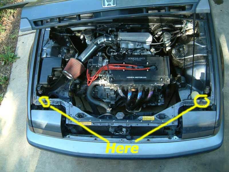

    on the corners of the front like radiator suport they have like 2 rubber things....you twist them to adjust the hight you want to set it at.

    Adjusting body panels is an art. You just have to spend some time doing it. Adjusting the hinges, the bumpstops on the front of the hood, like Messy explained. Just trial and error. It can take some time to get it looking just right.

    These are what messy is talking about.

    yeah i found them and got it for the most part good i need to move it back a hair and over to the right a hair and it should be golden. thanks for your help guys and legend that picture makes me drool every time i see it.... ahrllllllll b seriesssssssssssssssssssssssss
