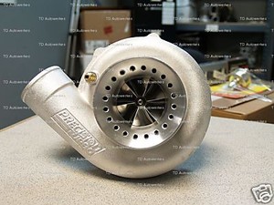

    very, it's capable of 700+ hp. SC6262SP

    I had to chase the ups man down(lol), I got it!
    I may need a 2.5" to 3" v-band adapter, but that will be it. Hopefully i'll get it in and tuned soon.

    T3 .63 A/R V-Band / Ported S-compressor cover (.70ar)
    Compressor Wheel billet: Inducer 2.44" (62mm) Exducer 3.310" (84mm)

    I may have to wait 1 more week, to run it. The freakin oil pan weld in bung did not make it this week.

    It's a Sc6262sp with the billet compressor wheel.It's a really nice piece.

    Thats a serious snail, Jerry. For my oil pan fitting, i drilled a hole, got a small galvanized steel adapter that both sides are threaded, but one size fits those cheap brass barbed fittings, and grinded all the galvanizing off, and welded it to the oil pan on the outside covering the hole I drilled. The steel fitting is not very big, maybe an inch or so long. I cleaned up the welds and rattle canned it. Strong, cheap, and no leaks.

    Sounds good, I ordered a 10an weld bung and a 10an oil return kit.
    The original fitting that i had was slightly back feeding. It was not that bad but with this new turbo I am not taking any chances.
    The new bung will be welded to a short piece of pipe which i cut at a decent angle to over come the backward angle of the oil pan.

    Pulled the pan and welded the new bung in, rebuilt the down pipe to fit the new turbo. Copied Tim on the vibrant muffler.
    Its not all here Tim, I am waiting on one little gasket.
