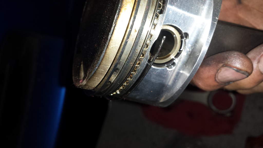

  16. #1041
    89T's Avatar
    Apr 2004
    3,020
    Re: The Journey 89 turbo'ed-----89T
    Well there's a laundry list of s*** wrong with it. Looks like the crank walked. Chewed up the bearing and the number 3 main cap. It was about to spin a rod bearing at the same location. piston number 2 the lower oil ring just hanging off of there. Hopefully the cam is alright. Question is do i do another a20or just dropped my b18 in there. It would be a lot cheaper if I just do another a 20. with the B18 and I would have to get a new intake, turbo manifold, downpipe, flywheel, clutch, pressure plate, cams, axels, mounts the whole nine yards.

  17. #1042
    89T's Avatar
    Apr 2004
    3,020
ID:	6990Click image for larger version.
ID:	6991Click image for larger version.
    un-motivated!
    it's simple if you ask me. Get a new A20. It's cheaper and you're making more power.
    Yeah I have a spare a20. It will probably go to the machine shop next week.
    What would cause it to walk though.
