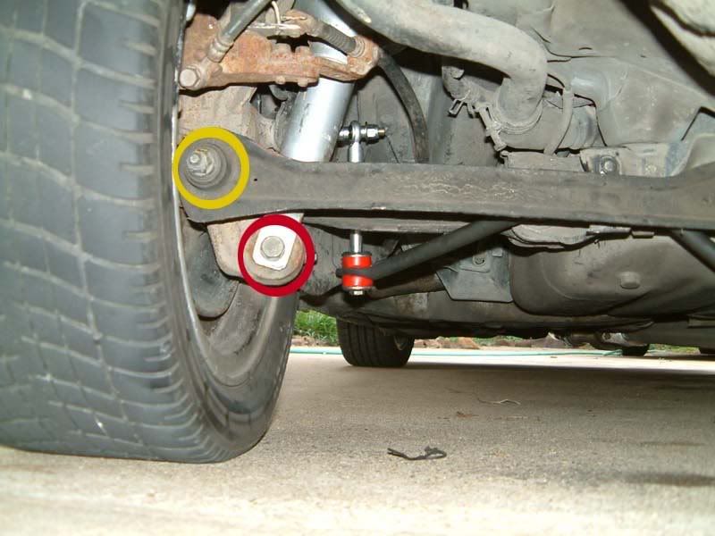

    Re: Rear Lower Poly shock bushings installed.
    The one highlighted in yellow is solid, the one in red is a bushing.
    The one marked with yellow is also a regular bushing that can be replaced
    Quote Originally Posted by thegreatdane
    In My opinion it is...
    I was looking at the Honda EPC and it is replaceable bushing like any other,
    so i dont know why You (I mean Legend_Master) claim its a solid one...
    I could take some more pics, but in 2 months time, when temperature get higher, couse I dont feel like laying on the ground when there is 0 Celsius out side.
    Quote Originally Posted by P|eszczoH
    It is removable and replaceable, but I don't believe it is made of rubber. That is why I call it a solid bushing. I might be mistaken, but that is the idea I got from taking mine apart.

    Talking Re: Rear Lower Poly shock bushings installed.
    hmm I got an opposite feeling when taking mine apart...
    One thing I know, One of us is in a mistake
