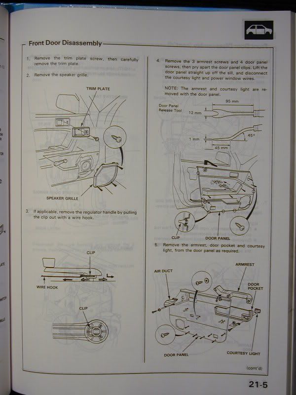

    Has this happen to anyone before? I was coming out of the store and went to open my door and on one side of the door handle came off or broke..the other side of it is still on but it doesn’t function anymore. Is this going to be a hard job to do? got to fix it.. does any one have a break away view of the drivers side door…on an 89 accord lx power window and locks.
    89 accord lx..carb
    259,000+ miles
    Re: broken door handle
    yeah they are easy to replace...you would have to take off the door panel and couple screws and you are set.
    Apr 2006
    2007 Cobalt LT Coupe
    Moose Jaw, Saskatchewan
    464

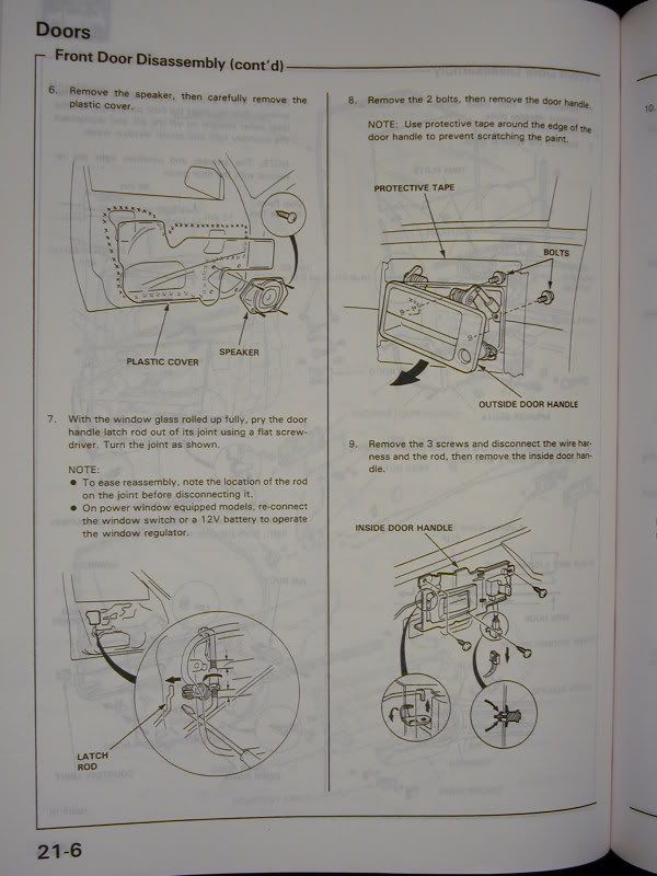

    here you go
    88 LX(x3)87LX(x1)86LXi(x1)
    New Jersey
    425
    yeah, they break just-like-that, and are a real biatch to fix, don't ignore the tape around the outside tip from the manual if you value paint. new are about $35 + shipping at majestic, ebay is risky as there are a couple of different models of handle and it's gonna be hard to nail the right color..besides..you need it tomorrow right?
