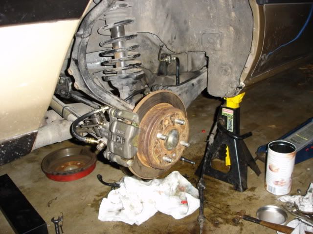

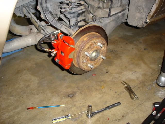

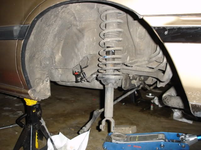

    well here ya go. i've been trying to do this for as long as this thread has been alive. so today my brake lines came in. decided today was as good as any to do this, so here i have one side on. still working on the left side. hopefully i will not have any more problems. but i just wont count on that. anyways, i'll be back to work.

    so imagine the rusted parts on the rotors black and the calipers and brakets red.

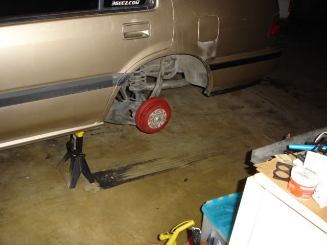

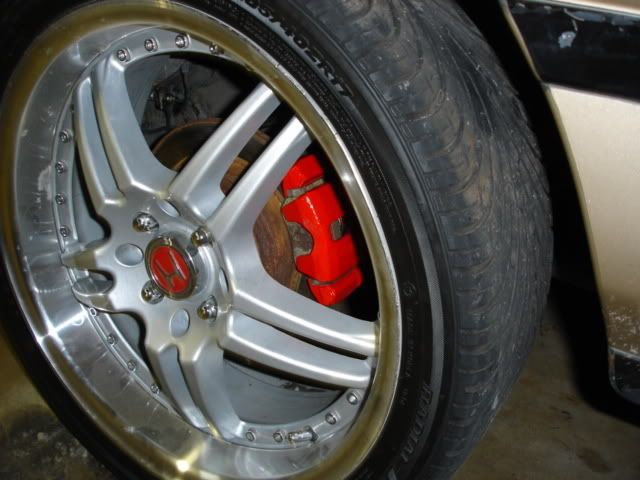

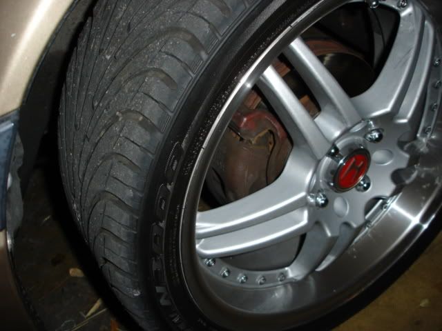

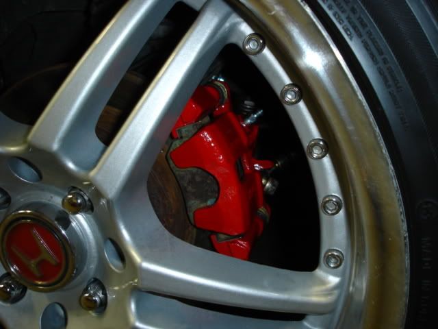

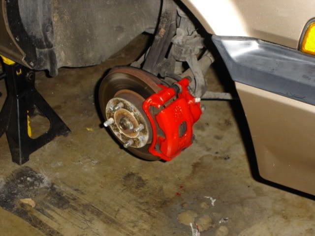

    well my car isnt driveable due to the busted transmission. so i decided to get the brakes painted. still need to finish them and do some touch ups. but they looks pretty good. they definately stand out. thats a red color if your monitor is making it look orange.
    finished product. got the rears done. really took my time and they came out really good. tomorrow the fronts and transmission comes out.
    now the fronts
