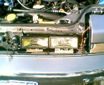

    fixed my fog lights..just bought whole new wires and switch...my fog light kit didnt come with a relay..just 2 ground wires some light wires and a power wire that has a fuse on it. so anyways replaced everything but the lights bought a kit from autozone for 7 bucks.
    http://i127.photobucket.com/albums/p...01/lights1.jpg
    http://i127.photobucket.com/albums/p...rms101/003.jpg
