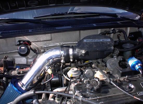

    the box there talking about is not an air filter box.... i guess you need a picture to actully see what there talking about, i will get one and post it up from one of the links in a minute
    **edit** heres pics
    as you can see there not talking about a air filter box its a box that mounts to the carb very well with very little modification, theres other ways to do it but this is one of the easyest ways to get a cold air setup for a carb

    thats exactly the type of thing i'm talking about
    just extend the tube to behind the bumper or some where away from engine heat and your laughing

    thats a civic AIR BOX on that carb.... its not fuel injected its carbed theres no way to just plug up a pipe..... noobs...

    yup u after use the civic carb airbox to use a cold air intake or short ram intake since the 3rd gen carbs have big fat intakes that dont have tha round hole lol

    wel sorry guys, i'm not terribly familiar with civic parts
    most people i know would call that a plenum chamber eventho its a carbed car
    Down this end of the world an air box is where the air filter goes,everything else is just ducting

    I need something like that to fit 32/36. I saw that PGM Fi civic air plenum in the JY last week , I should have grabbed it.

    your correct thats its actual name... its just allways been known as "the civic air box mod" ever since i started learning about them almost 2 years ago

    what exatcly is that called the air box that mounts on the carb. and where can i find it i keep looking and i cant find it anywhere

    you can find one from any 88-91 DX CX STD LX civic at the junkyard. ill have one on here for sale as soon as i convert my civic to MPFI

    yeah go to the junkyard and get the piece off a civic and then get ur piping for the intake and a filter. u are gonna have to mod the hole on that piece where it mounts to the carb. after you get it and try to put it on ur carb ull see what i mean. and see where u got to cut the hole a lil bigger or drill a new hole i think for the bolts to secure it.it will use the same two bolts that ur stock big air filter box uses.. and then mount ur pipe and filter how you want to that.i think the shorter the pipe is the quicker throttle respose but less top end. and longer pipe is a lil slower throttle response but alot better top end. but i think it is close to ur hood or will rub r somthing i dont remember.
