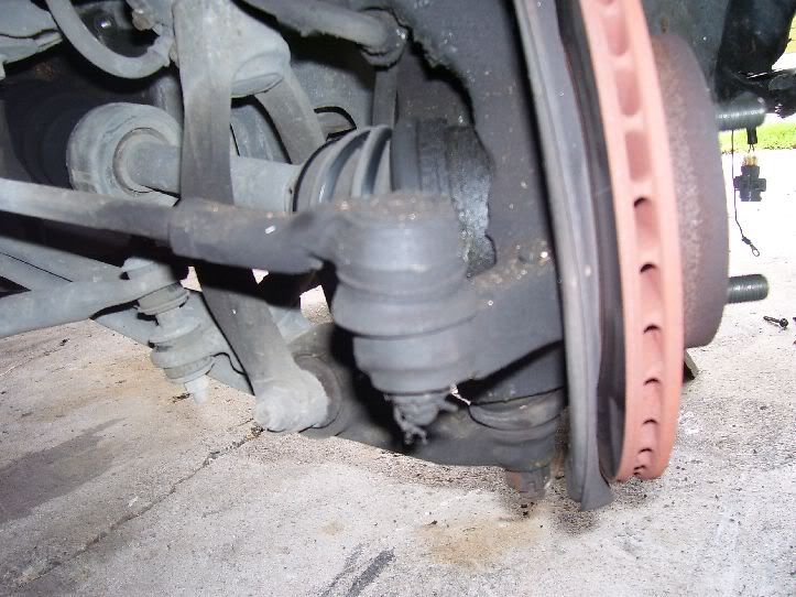

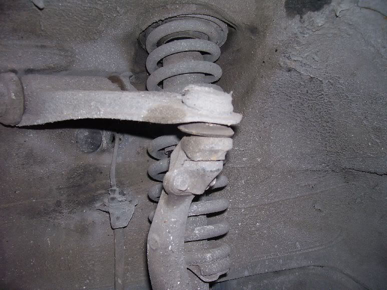

    when i got the car, i forgot to ask which ball joint needs replacing so i'll just ask, how do i tell if i got a crappy ball joint?
    does anything here look bad?
    i didnt notice any play or anything if im supposed to either
    i havnt seen the left side yet though
    PS: i dont know exactly what im doing

    Standard front end check,
    1: jack up one side of the car until one tire is off the ground. The other side tire must be on the ground still. I use the jacking point under the doors.
    2: grab the tire in the air at the 3 and 9 o clock postion and shake/rock back and forth. slow at first. You might need someone to help look underneath. This checks tie-rods,steering rack etc. start kinda slow and work your way up a little harder. Your looking for loosness in the joints. Use common sense of course the steering wheel will move or the other tire may move if you shake the shit outta it.
    3: Grab the tire 12 and 6 o clock. Rock back and fourth.This checks the wheel bearing and ball joints and upper links. There should be no play in the wheel bearings.
    4: this check might show ball joints/upper link a little better. Use a pry bar under the tire at the 6 o clock pos. pry up look for slop ,looseness while prying. The upper link ball joint and bushings near the body are what your looking at.
    This is your basic "front end check" any good mechanic should know. It works for all makes and models of cars.

    i already got a spot for next week...im going to replace lower and upper ball joints.

    jack the car up and the wiggle the the top of the wheel if it moves the ball joint is bad

    if theres any queston whether you need one then you probly do
