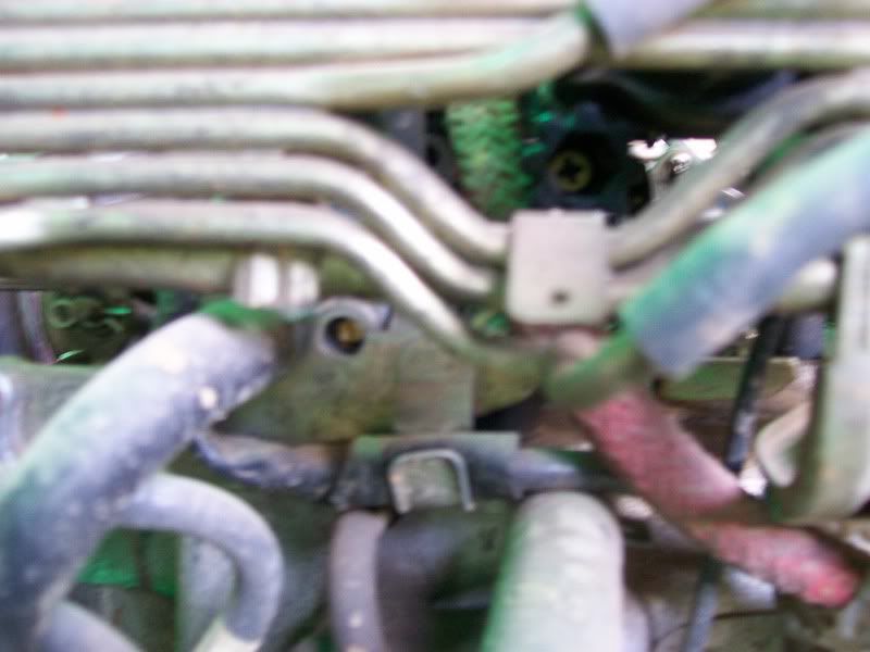

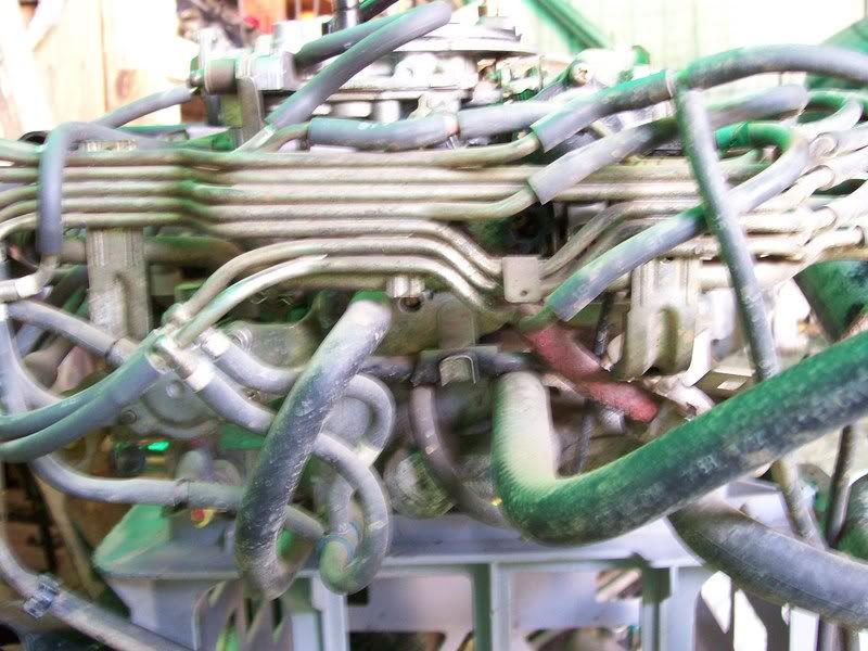

So here is what happened, as I said I knew the car was running lean but I didn't worry about it for two reasons, firstly the carb had just been sent away and reconditioned and the mechanic had fitted it all back together and what not. Secondly as I understand it there is a cover which has to be remove to adjust the mixture? Seemed like too big a job just to turn a screw.
So, now I need to know where the screw is located for the mixture so I can adjust it, many, many thanks to anybody with pictures and or advice.

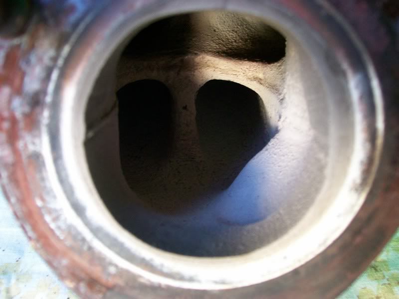

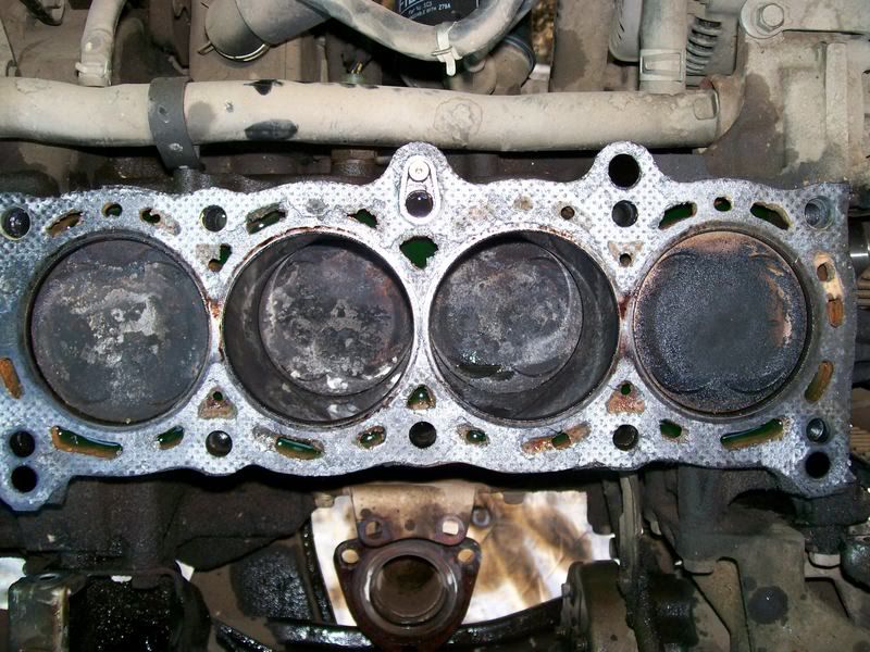

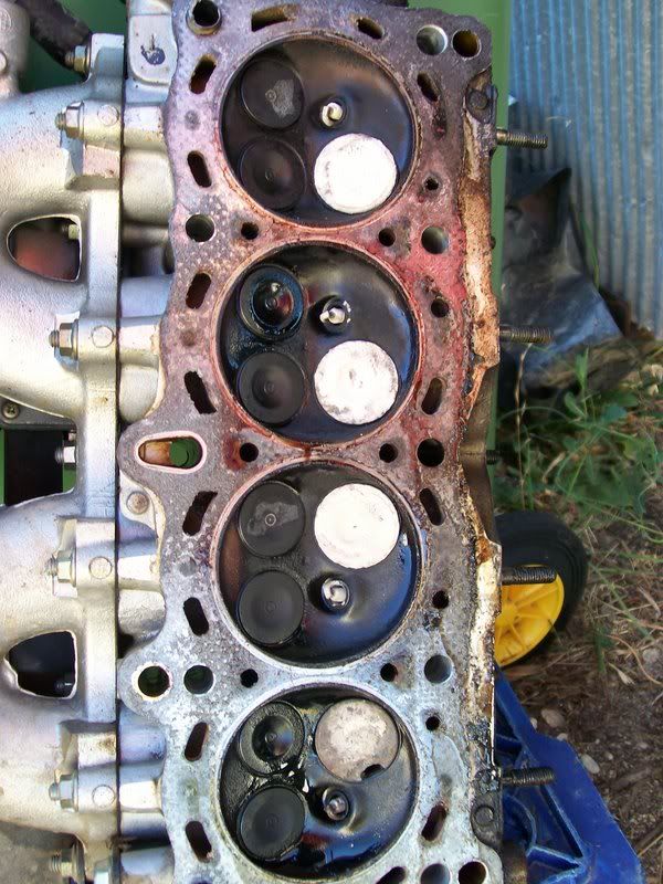

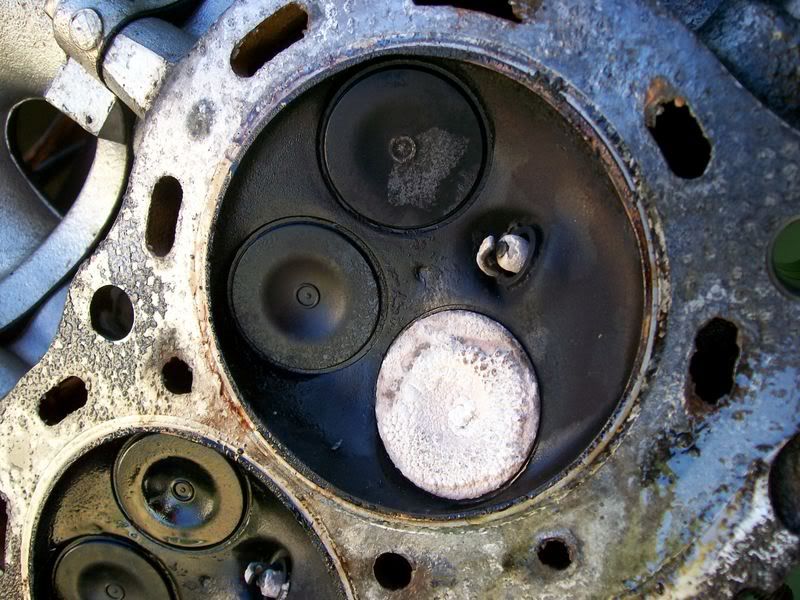

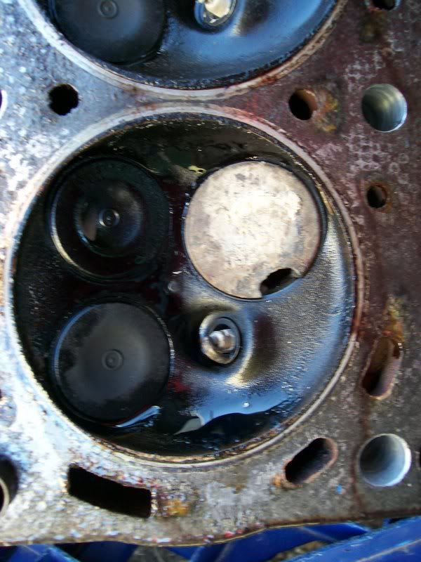

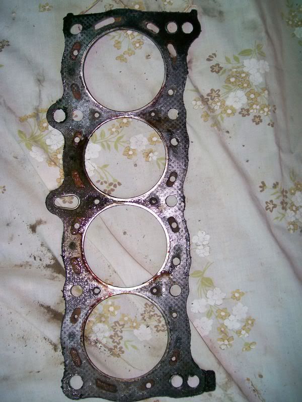

As you can see by the pictures, it was running rediculously LEAN.
Notice the problem![]()
#1 cylinder, 2 and 3 were in the same condition
#4 cylinder
