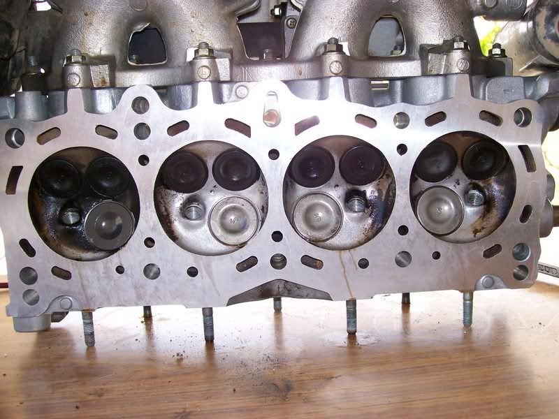

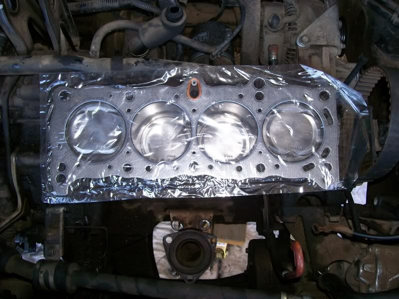

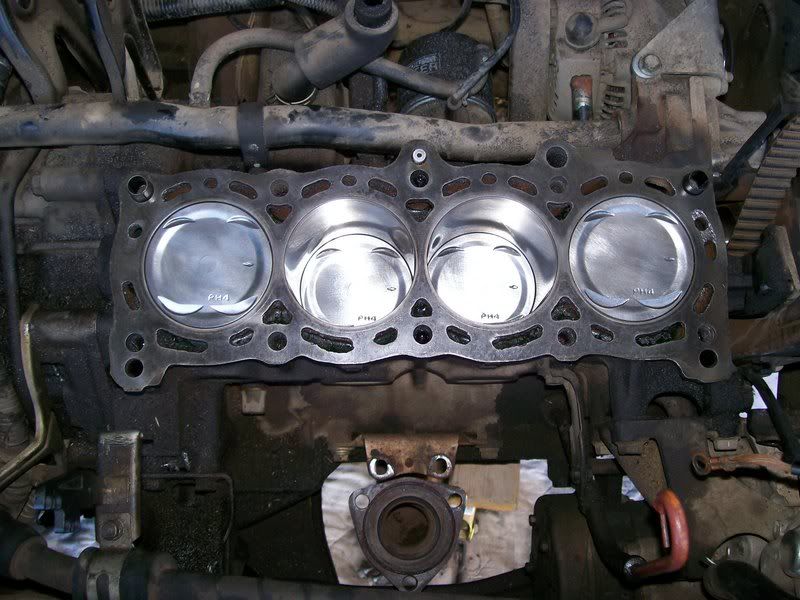

    Well guys, it is all done. Got the Accord back together and running. Took me 6 hours to take the head and everything else off and 6 hours to put it all back together. Mind you in probably only took 5 hours when you take into account toilet stops, lunch and what not.
    So as you can see by the pictures it came up pretty good, got to give the engine bay a good scrub now and sell it :P
    Going to get a Prelude or a Legend Coupe. Certainly wasn't going to sell it for $400 that is for sure.
    So here is some pictures and a short video.

    Wasn't sure whether or not to take the plastic off the new gasket so I just left it on.
    http://www.youtube.com/watch?v=pymM4Al4uq8
    Re: Probem Resolved
    you left the headgasket gasket plastic on?....hope it does not leak....anyways nice engine how did you clean it?

    ???? i hope you took the plastice off before you put the head on!

    I think he's being funny.
