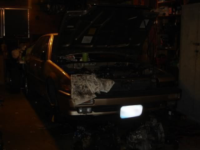

    nah, auto is nice. this is my daily driver so its great for the city. manual gets tiring in traffic. anyways got my old one out and the new one is ready to go in. should have it done tomorrow. my uncle that is staying with us is helping me do this so its going well.
    you can see where my distributor has leaked all over the transmission. i've had the O ring for it for a long time but never replaced it. so now i'm going to so that mess doesnt happen again from happening again.

    I'll jump in with a good tip for us manual guys. Always but a bead of permatex around the bell housing when changing tranny or doing a clutch. It saves oil coming down and ruining the clutch. Its and old Chevy 350 trick I learned.
    Check your thermostat housing real good for leaks its a good time to fix it out in the open like that. It looks crusty.
