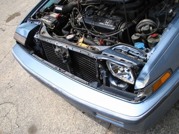

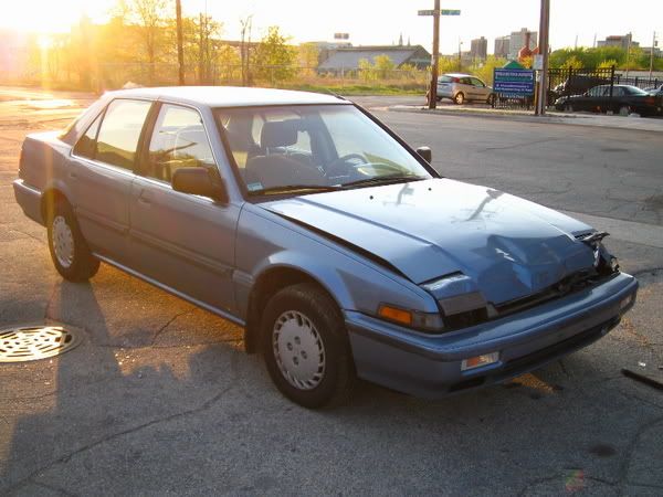

    I rear ended a truck on the highway. It sucks, this is my first accident, and I had 4 people in the car, lots of rain, only 2 lanes of traffic with concrete on boths ides. Truck in front of me slams on his brakes (which is fine, I was very far back, not tailgating or speeding), and unfortunately his brakes were better than mine. I think I hit him at 5-7mph somewhere, but his stupid truck bumper went OVER the accord's bumper, smashing the hood, both headlights, and shoving the condensor and radiator backwards. Think it's fixable? The rest of the car is in such clean shape... I really really really don't want to part it out.

    well, to have it fixed propperly, you're gonna be replacing that radiator support (the entire front end)...
    get some better pictures (don't take any funky angles to get the whole part in the shot, jsut zoom out or back up)... coming from experience, i've seen cars look ok-ish in pics then when i see them, the damage is significantly worse than anticipated...
    and if that were to go to a shop, it would cost in the thousands...

    Does the radiator support cradle the headlights? Pic #4 is what worries me.

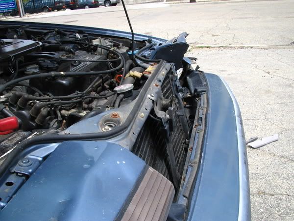

    So wait wait wait. If I get a radiator core support, can I just unbolt the whole bent part? I mean, even the part where hte headlights are bolted into is pushed back an inch or two.
    SEi User 3gn86lxi's Avatar
    Jul 2004
    wa
    1,598
    It is bolted together, but it is also tack welded. So you would have to drill out the welds, unbolt the bad one, install the new one and re-weld it.

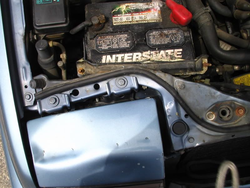

    As you can see headlight cradles (?) are bent inwards and are touching the battery. Does that include the radiator support?
    - Rob
