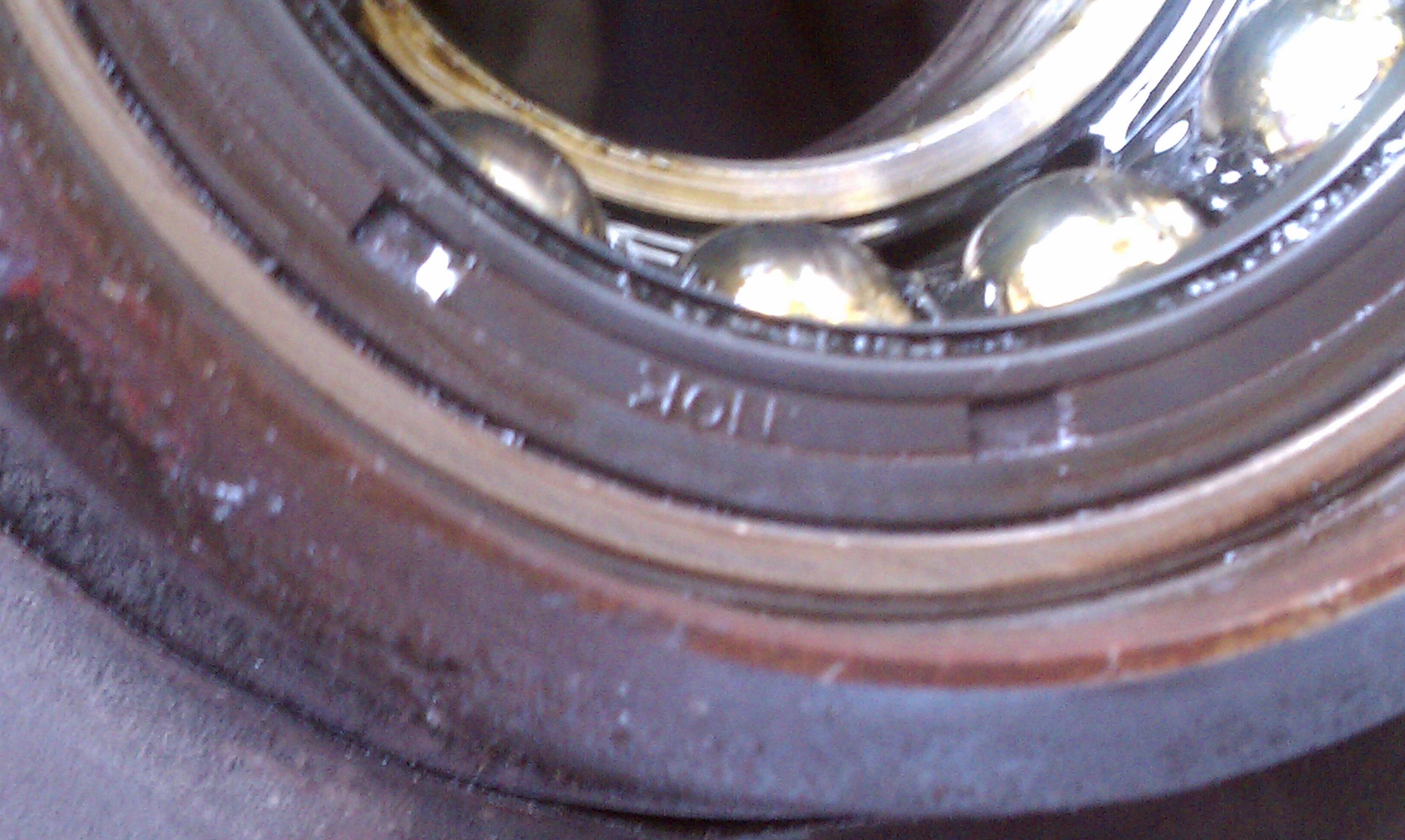

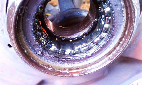

    My original bearings are original wheel bearings sandwiched against a bearing race for both inner and outer bearings. The center main race is more or less a pressed in race into the bearing hub. and two bearing races one semi-permanant pressed onto the wheel side hub. and the other is fitted onto the axle side with a tight slip fit. Not sure if you can see in the pics but..its a bugger to pull apart and impossible to remove the outer race from the wheel hub side.
    I am sorry I didnt take better pictures when I did have it apart in "july".

    I see what you're talking about... I don't know that the inner sleeve of this style bearing is called a race. You have a good how to there at h tech to guide ya through though!

    messed up the quote....... but if you read the HT article closely taking apart the race from the bearing its ruined. Pressing it back in new its one piece. They rely on the hub nut torque for there preload.
