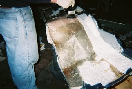

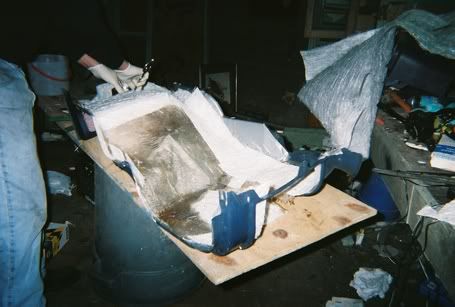

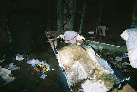

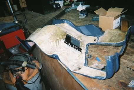

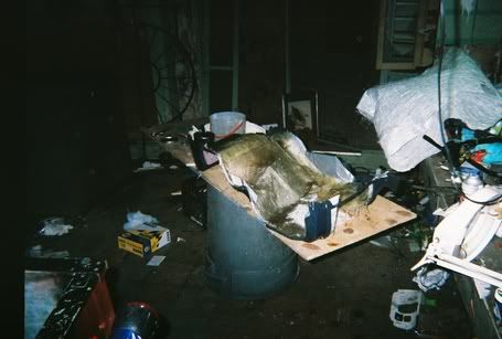

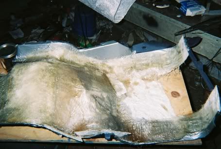

    well I used an actual plastic piece from a hatch,I put a wood block on it for where the monitor goes,then it was a lot of filling and shaping with bondo,then I covered the entire thing with duct tape,fiberglass resin peels off of ducttape. then it was simply laying mat into it and saturating it with resin,then trimming the entire thing after it was peeled off. it fits over the plastic in my car but has extra space now for the monitor.
    Re: fiberglass caps for the inside of the hatch

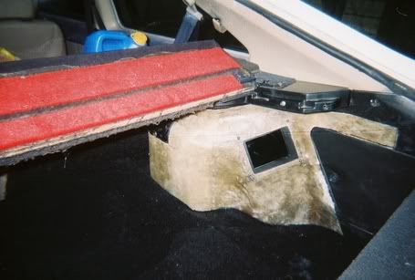

    ok here are some pics,it's temp mounted in the hatch,I still have some trimming and fitting to do,then I have to take it out and upholster the entire thing in the black tweed. but this is how it fits anyway.

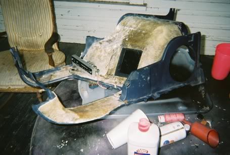

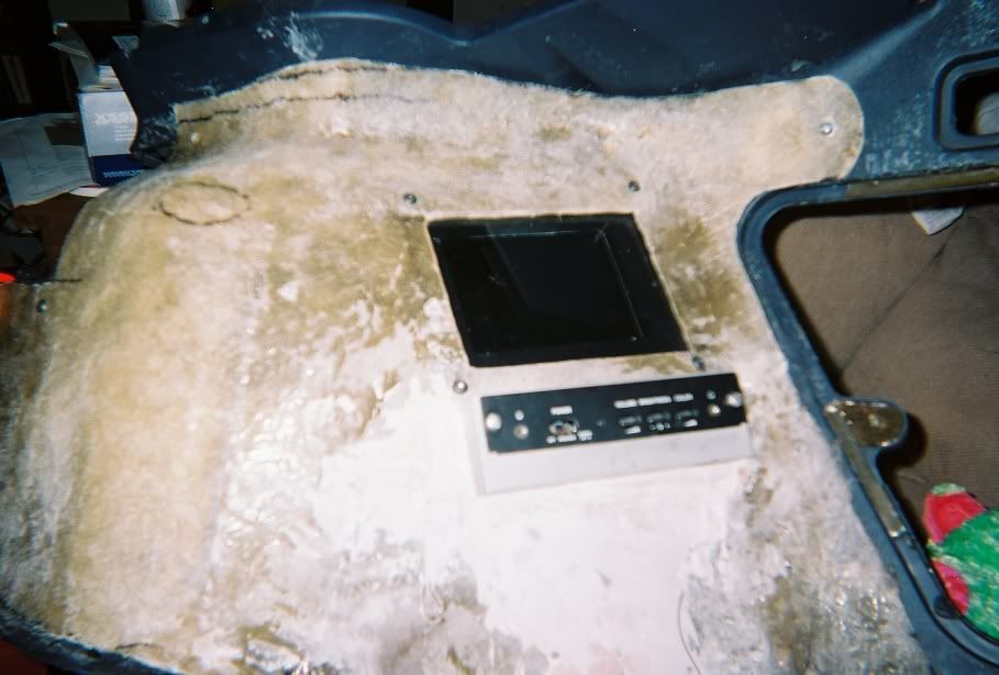

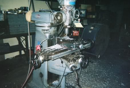

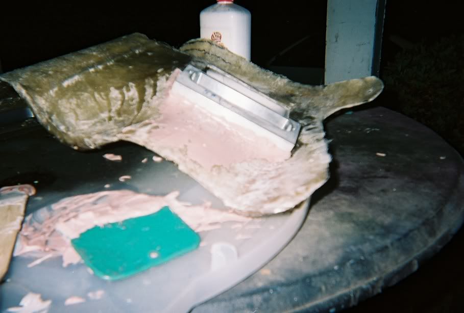

    ok some progress,I'm almost done with the main fiberglass piece that holds the monitor,I'm finished with the two smaller fiberglass pieces that also go on that side,they are also upholstered,I have to do some filling and some more sanding on the main piece before i cover it,but i also made the piece that holds the monitor controls out of aluminum.
    it's snowing aluminum!!
    the piece after being machined from a block

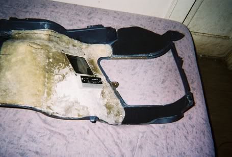

    for a note,the black pieces on here are already covered now,this is what the main fiberglass piece will look like when it's finished,I was going to glue today,but we had a line of severe thunderstorms go through here,and the humidity is way too high for upholstery glue. have a bit of filling to do yet on that piece,but not much,the areas on the plastic part in the car not covered by material will be painted graphite black. then the fiberglass pieces attach with trim clips to them. maby by next thursday i'll be able to get this thing in.
