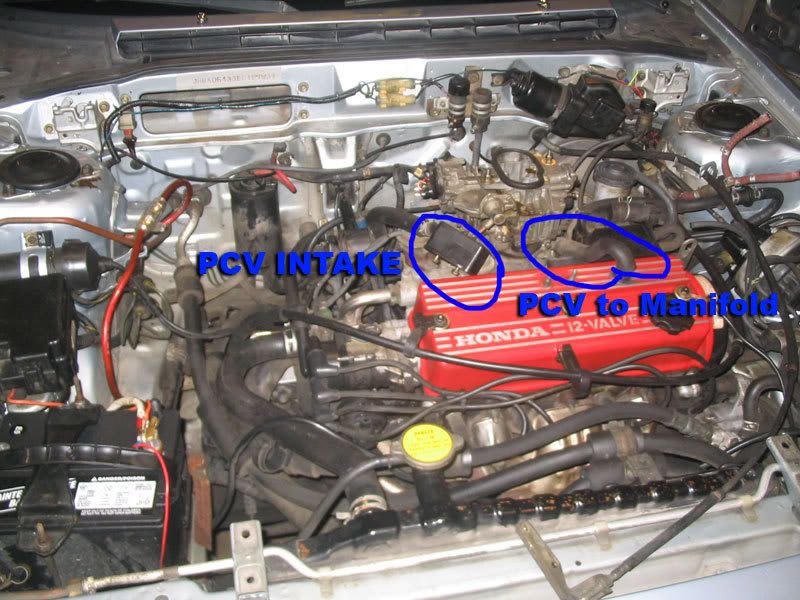

    No, I don't think it's the PCV breather hose. The PCV breather hose connects to a little box with a foam filter in it. That's attached to the back of the air cleaner box, but doesn't take air from the filtered side of the element.
    I think you're talking about the big hose on the side that attaches underneath. I'm pretty sure that goes to the air suction valve. I'm not 100% sure what exactly the air suction valve does, but I think it brings fresh air into the exhaust to help with better burning in the catalytic converter.
    Here's a picture of the car with the vacuum lines removed.
    The PCV intake is that little box with the hose on the back of it. That runs down to the crankcase and takes the fresh air in. The other PCV line is where the PCV valve connects into the valve cover and sucks gasses out of the crankcase to be burned in the combustion chamber.
    The PCV system in the A20 flows the opposite direction. It sucks in fresh air through the valve cover, then vents out the crankcase near the bottom, and is seperated by an air / oil sperator box. From that box it goes up to the intake manifold...
    That's why you see the A20 guys with the little air filter on thier valve cover. And why the ES2 can't do that.

    Re: You know that big hose under the air cleaner...
    I think you have the right hose circled. It's molded, but more like a spongy consistency than a normal hose. It definitely holds that air breather on. There weren't any clamps on it either, but they could have been removed at some point. It just fit really snug on the underside of the assembly. That engine bay looks very familiar to the one we were working on last weekend... What a mess to work around, but sorta fun and challenging, too.
