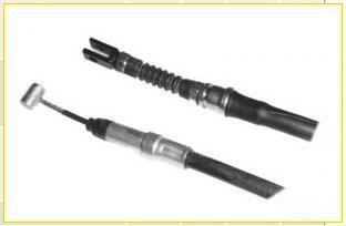

    and yeas the sei cables are different at the end where they connect to tha caliper. It is two pronged fork shaped at the end compared to the solid square end used in drums.
    remember not only do you need the cables but also a pin that goes through the forked end that holds the cablke to the caliper arm. youll also need a slip pin to hold the othe pin in place.
